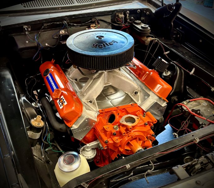

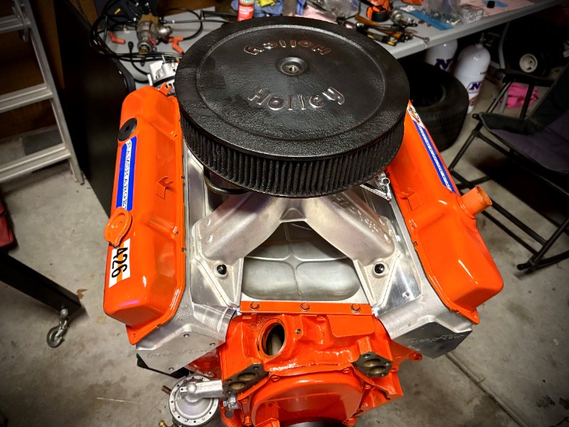

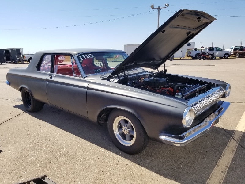

A valve seat fell out of the old Stealths, killed the valves, destroyed the heads and pistons last fall.
We are almost back together with a sleeve, new pistons and new intake.

That pup should ride. That Victor look-alike is a good manifold. It should love upstairs like the Victor to the point of nose bleeding.
Is dropping a valve seat a common problem with 440 Source heads?

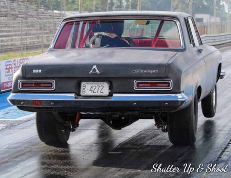

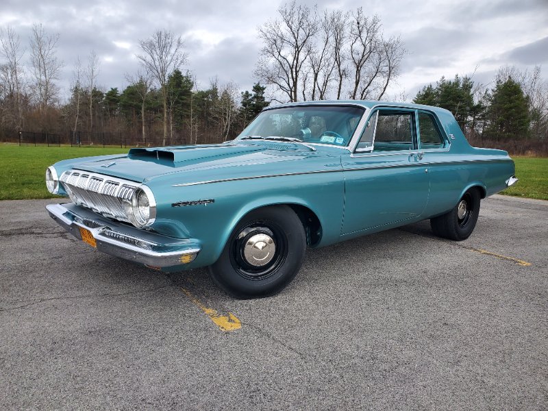

How about some pics of the car!
I’ve learned that they have a much shallower valve seat depth than other comparable heads. They did last for 10,000 street miles and hundreds of drag strip passes. I’m the poster child for torture testing things like that. Still not happy about it.

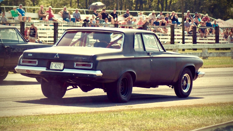

Very nice car/chassis setup, very level side to side front wheels up! I notice the lack of the 330 side trim, I'm looking for a LR 1/4 piece .
