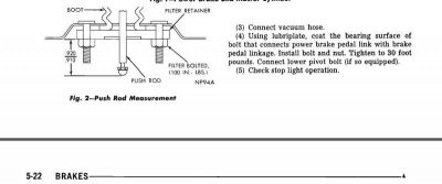

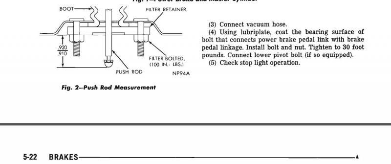

Hey John,
What booster & master are you running? Did you happen to check the pre-gap clearance between the rod coming out the booster and into the back of the master? The Service Manual gives you a total length from the face of the booster to nut end. You can also verify by looking down in the bore of the M/C, and view down in the weep hole to see if the piston is all the way seated when the brake pedal is at rest. I use mechanic's wire or a fine diameter tig rod to put down in the rear weep hole to ensure the piston is all the way back. Trick is to have a very, very small amount of play with the pedal before it engages. Last thing you want is a preload.
Just throwing it out there, but what happens with a poorly adjusted rod (be it manual or power), is if there is a preload, your brakes will never fully disengage. Your brakes will drag, heat up and possibly lock up (until cooled down). Too much of a gap you will have too much freeplay in the pedal before braking actually occurs, and can actually hamper the full braking capability of your car.
using a strong flashlight shining in the master cylinder "air bleed" hole, when you loosen the nuts holding the master cylinder to the booster, you should not see that valve move. If it does then the brakes are applying and the rod is too long. This is a common issue and effects all makes of car. Common with replacement parts and just a little grinding will fix.
further on what Propwash was saying
