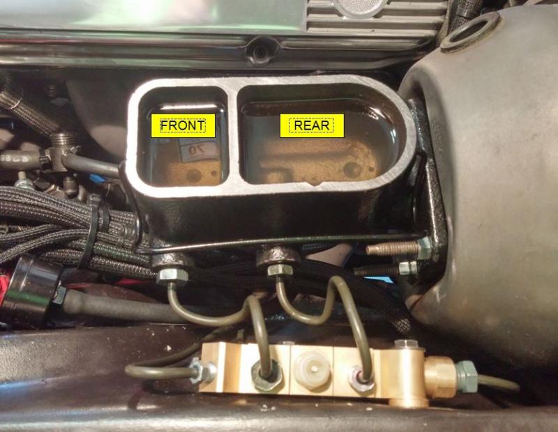

Installed the new Pirate jack MC, the picture below shows how I have it hooked up (Switched from the current picture.) Currently when I have the brakes all bled down and close all bleeders, push the pedal down the front brakes are locked SOLID.
I have checked the booster rod by loosening the MC while the brakes are locked, if I move the MC back from the booster the brakes remain locked.
I am sure the proportioning valve is installed correctly.
Except for the master cylinder ports being wrong, I cannot think of what is the problem.
When the brakes are totally locked, if I open the bleeder at the wheel cylinder the disc's are then free again. Dang it!
Here is how I have the MC plumbed...
**UPDATED: I switched the master cylinder to proportioning valve lines and that cured the front discs locking up, now the rear drums are on all the time. Maybe I got a bad master cylinder residual valve? Anyone heard of that?

The way he has his master labeled, isn't it backwards? Pretty much same deal on my conversion, using a new disc/drum master. The larger (rear) bowl should go to the front disc brakes, since discs take more fluid movement.

The picture is labeled wrong kid. The reservoir for the front brakes is the one located to the rear of the M/C, (closest to the firewall). Going through his last couple posts, he mentions that he did swap it back to the correct configuration.
I'd imagine you are having the same issue as John. Yeah, those nuts are no treat at all. I cannot think of a harder nut to get to on the car, than the right upper. Well, maybe the dash pad Pal nuts would rate right up there as well.
Yes sir Will, picture is labeled wrong, but it is also plumbed wrong in the picture, the larger reservoir (front disc) needs to be plumbed to the front of the distribution block (left side) and same goes for the rear reservoir.
