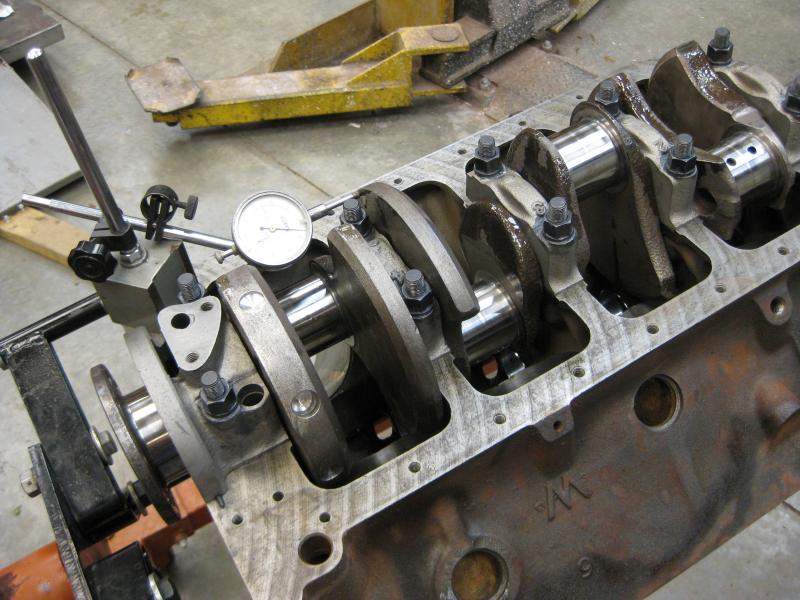

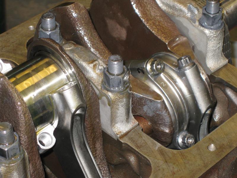

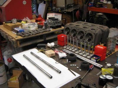

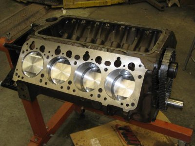

The one you see in the picture is just a mock-up. The one that is actually going in the car is a .060 over 354, stock crank, H-beams (modified Pontiac), Hyper pistons, main studs, Pocket ported iron heads milled to a 100cc chamber, oversize stainless valves, stock rocker assemblies, stock oil pump, Isky B777 Solid lifter cam 108 lc, .480 lift, 240 degrees @ .050, adjustable pushrods, Hot Heads intake and 2 600cfm carters. I will have to fabricate the headers and the pan to fit the chassis.
