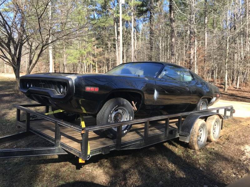

I’m new here and I’m new to the Mopar world. I’ve been IH and GM up until now. I recently acquired a 1971 Satellite. Body is really good, no motor or transmission. I’m wanting to build a “daily”, but not a true daily. Something reliable and fun to drive, but something I can take and attempt to run time trials and autocross a little.
I have a few questions, but one at a time.
I’m planning on running a magnum 318 with a manual transmission. But the car was originally an automatic. I was thinking about an NV3500. Will this fit? And what’s a good starting point for hanging a third pedal?

Y’all are awesome. I appreciate all the info. I only have one pic and that’s when I came home from getting her.
