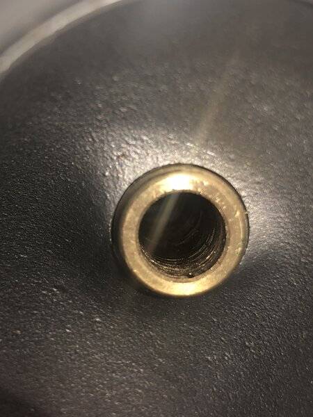

Working on a set of brand new 440 Source Stealth heads. The valve guides seem excessively tight.

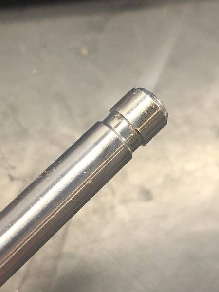

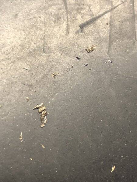

The heads were disassembled to be checked before installation. Unfortunately, the valves were really tough to get out just by pulling them. When they finally came free, there were brass shavings coming out. It appeared like the top of the keeper grooves were actually cutting into the guides. Getting them back in required a good smack with a soft mallet.
Brass shavings.
Note brass shavings under top of keeper grooves.
Note the scratches in the guide.
Not sure if this situation is really bad, normal or somewhere in between. Never had this happen to me before so I have no point of reference. I'm thinking it can't be great. Obviously you don't want loose guides but given that the heads will expand, I'm thinking the valves are going to stick and/or get burned up.
So if this needs to be fixed, whats the approach?

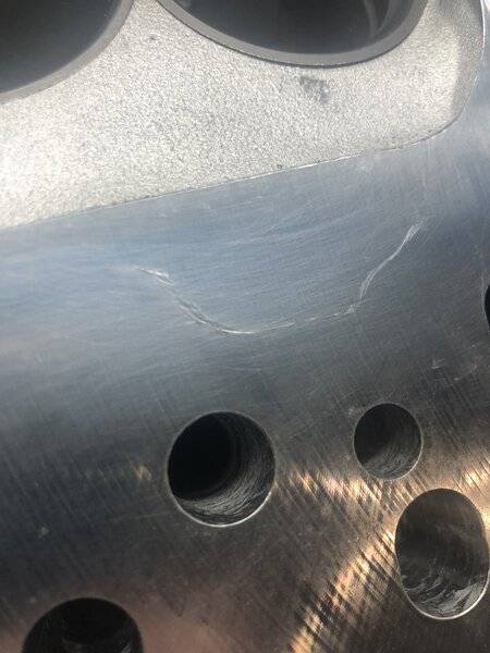

Second issue - this seems to have happened while handling the heads, not really sure how but there is a pretty good gouge/scratch in the head surface. You can definitely catch a nail on it. Thinking the edges should be smoothed over with Scotch Brite but that's it? Hoping the head gasket will seal this up, using Fel Pro 8519-PT-1.

The keepers, especially with strong springs, will burr the edge of the groove on the valve and this is why they shaved the brass guides when you removed the valves. I usually will use a file to dress the grooves to prevent this before I remove the valves. A valve guide ball hone should dress the scratches and hone to get a little more stem to guide clearance. Check to see if the scratch is inside of the gasket, and if it is, don't worry about it. If it is outside of the fire ring, no real need to worry about it, but if it crosses the fire ring, have the heads surfaced to just clean them up.

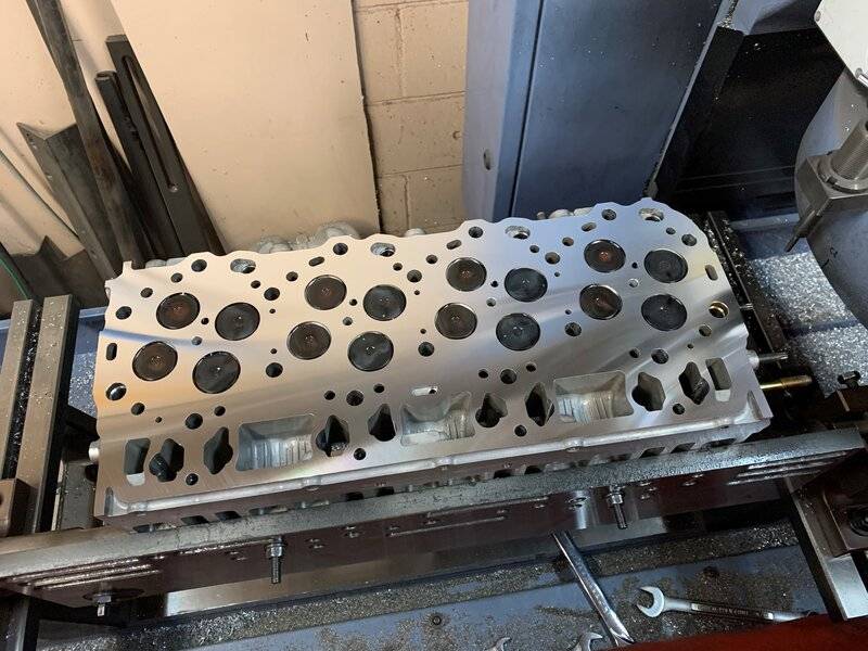

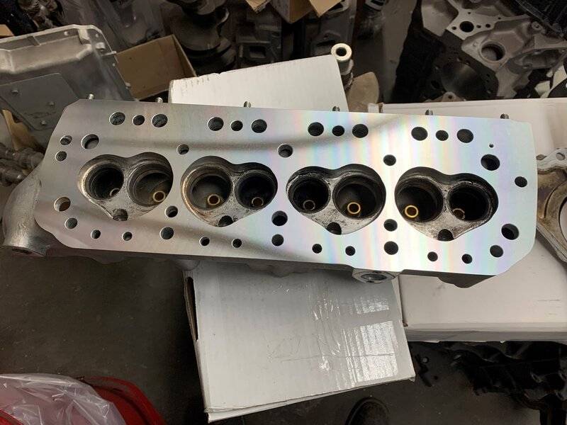

Also, it would be best to find a shop that uses a "Diamond" cutter to mill heads, and not carbide, abrasive belt, or other old fashioned method. These are aluminum heads I have cut using a diamond cutter.
Thanks. Was thinking the keeper groove would need to be dressed but I'm not sure with what.
And yeah the gouge is definitely inside the fire ring so yeah, duh, no gasket will seal that up since there is no gasket there... Doubt our local shop has a diamond surface cutter, may not even be able to do it himself, probably sends it out.

Get the heads milled to remove the gouge.

I am going to suggest that there is NOTHING wrong with the Valve guides..... only your dis-assembly procedure.
Once the Heads are assembled, it is not uncommon , and usually typical of the stock 7* V/Locks that "Burrs" develop on the upper V/Lock groove in the Valve.... as usually the Valve tops get tapped with a dead blow hammer upon assembly to ensure seating of the Locks....resulting in Burrs.... and which to then dis-assemble correctly requires use of a small file to remove.
DO NOT "force" anything !
Spin/rotate the Valve with one hand while carefully filling with a small flat file that transverses the entire groove on both sides(Nail file with suffice) in the opposite direction with the other hand to remove the Burr BEFORE removing the Valves !

As has already been said........ the reason the valves don’t come out is from a burr that’s been raised on the upper lip of the keeper groove by the stamped locks.
This is not a 440 Source thing.
It’s the same for any head with stiff springs using stamped single square lock groove style locks.
Having to file off the burr on the valve before sliding it out of the guide is SOP.
If the heads use machined locks instead of stamped, the burr usually doesn’t occur.

On the gouge - I really have no clue how that could have happened. Looking at it from a cost perspective, I think it will be easier to buy a single new head rather than taking them somewhere to have guides and surfacing done to both heads.
