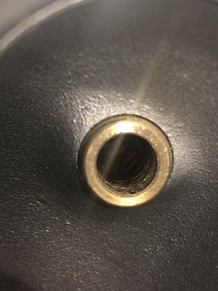

Working on a set of brand new 440 Source Stealth heads. The valve guides seem excessively tight.

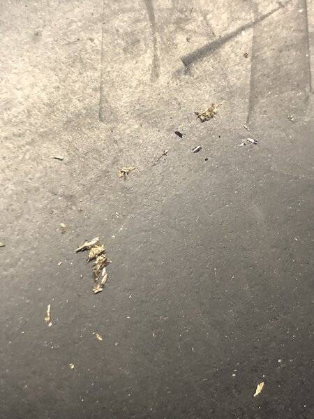

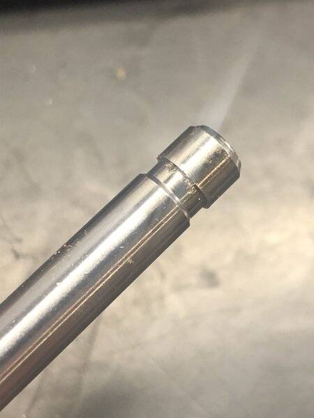

The heads were disassembled to be checked before installation. Unfortunately, the valves were really tough to get out just by pulling them. When they finally came free, there were brass shavings coming out. It appeared like the top of the keeper grooves were actually cutting into the guides. Getting them back in required a good smack with a soft mallet.
Brass shavings.
Note brass shavings under top of keeper grooves.
Note the scratches in the guide.
Not sure if this situation is really bad, normal or somewhere in between. Never had this happen to me before so I have no point of reference. I'm thinking it can't be great. Obviously you don't want loose guides but given that the heads will expand, I'm thinking the valves are going to stick and/or get burned up.

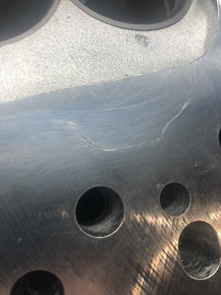

Second issue - this seems to have happened while handling the heads, not really sure how but there is a pretty good gouge/scratch in the head surface. You can definitely catch a nail on it. Thinking the edges should be smoothed over with Scotch Brite but that's it? Hoping the head gasket will seal this up, using Fel Pro 8519-PT-1.

It's been suggested to me that the manual spring compressor we used could be what caused the burrs in the keeper grooves. Makes sense especially if it's a little tough to operate the tool. I'll take all the credit for blowing through the roadblock of the valves hanging up and forcing them out before dressing the edges.
Regarding the gouge - after talking it over with my friend, we've kinda figured out how it happened. That spring compressor I have can be a little bit of a bear to operate. I did the first head and then handed it over to my friend to do the second one. (We marked them 1 & 2, the head in question is #2) He'd done this operation once before with the same tool on a set of stock iron heads with lower spring pressures than what comes with the Stealth heads however, it was a bit of a struggle for him this time. But that's how we've been doing this entire project - I show him how to do something once or twice then he does it so he can learn how to do it and/or screw it up himself.
Anyway, I got it ready for him and went to do something else not really paying attention to what he was doing. From what I remember, I did hear him fumbling around and cursing at one point so it must have slipped off the valve and caused the gouge. Unfortunately, I don't think he realized what happened nor did I bother to go over and check what he was doing. That was the last thing we did that particular day so once he was finished he put the head back in the box. I never even saw it or I would have said something right then. Not throwing him under the bus, **** happens, could have happened to anyone.
