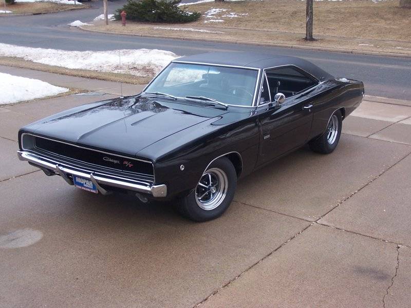

  • Car new hemi was put in (make, model, year): 1969 Charger
  • New gen hemi size: 6.1
  • New gen hemi year: 2008
  • What did the new gen hemi come out of or was designed for (car/truck): Challenger
  • Carb or EFI (type, brand, etc): EFI
  • What intake was used: Stock
  • What exhaust manifolds/headers were used: TTI
  • Modifications made to the new gen hemi: None
  • Type ignition used: Stock
  • What PCM was used: Holley Dominator
  • What harness was used: Holley
  • What front serpentine system was used: Stock
  • What alternator was used: Hemi 2005 unit with mopar adjustable voltage regulator
  • What PS pump was used: Stock
  • What motor mounts were used: Shumacher
  • Transmission used behind hemi: 833 4 Speed with 294 Rear Gear
  • If manual, what clutch was used: Hydraulic McLeod Kit
  • What transmission mount was used: Stock
  • What adapters were needed to get the trans to mate/work: None
  • What modifications were required to the car to make the hemi fit/work: None
  • Biggest challenge/problem encountered and how it was resolved or overcome: Getting the Dominator tuned, but I studied and got it running well.
  • What would you have done differently: Maybe going with Hotwire Harness
  • How do you like it: Love it....driving it daily now and waiting on my AC kit to install
