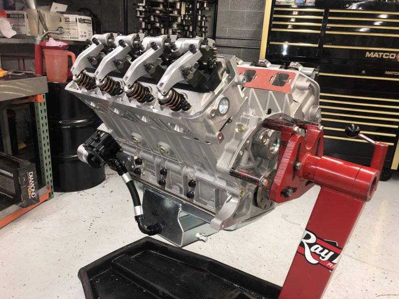

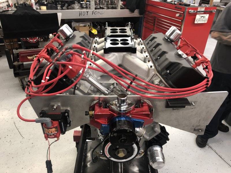

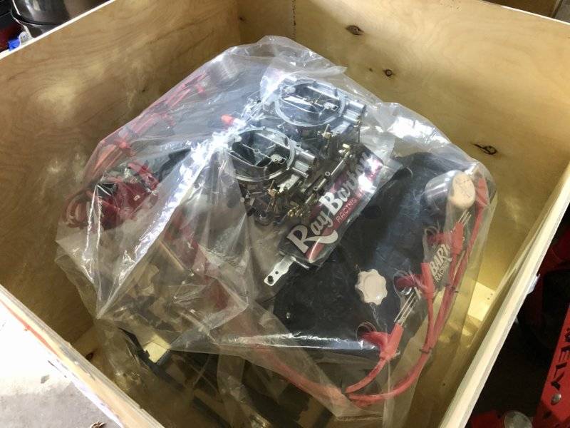

Finally got my engine I’ve been waiting 2 1/2 years for. I went up to Ray Barton’s and watched it built and ran on the dyno. 540 CI, 10.5 CR, mild cam, Barton rocker system. Working on gathering everything up to put it in. I dropped the TKO 600 off at SST and had the upgraded shifter and carbon fiber synchros put in. Hope it’s better than old Keisler was.
What's it going in to, any Dyno #'s you'd like to share ? Thanks
The dyno numbers off the top of my head were 665 torque @ around 5100 and 708 hp @ around 6400. We did about 5 pulls on the dyno kept gaining about 5-8 hp each pull. They said that was due to rings seating in, beyond my experience, first time around a dyno. Never touched the 750 performers, they were running a little rich. I think we could have pushed the numbers up a little more with some fine tuning. It’s a street engine, plenty for my wants. It’s going in a 67 Satellite, I’m sidelining the old street Hemi and looking at going through it.

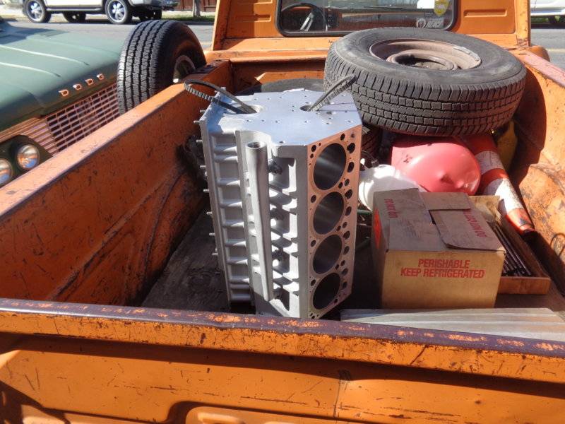

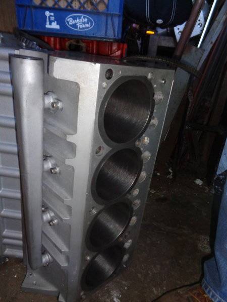

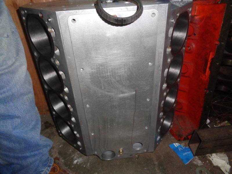

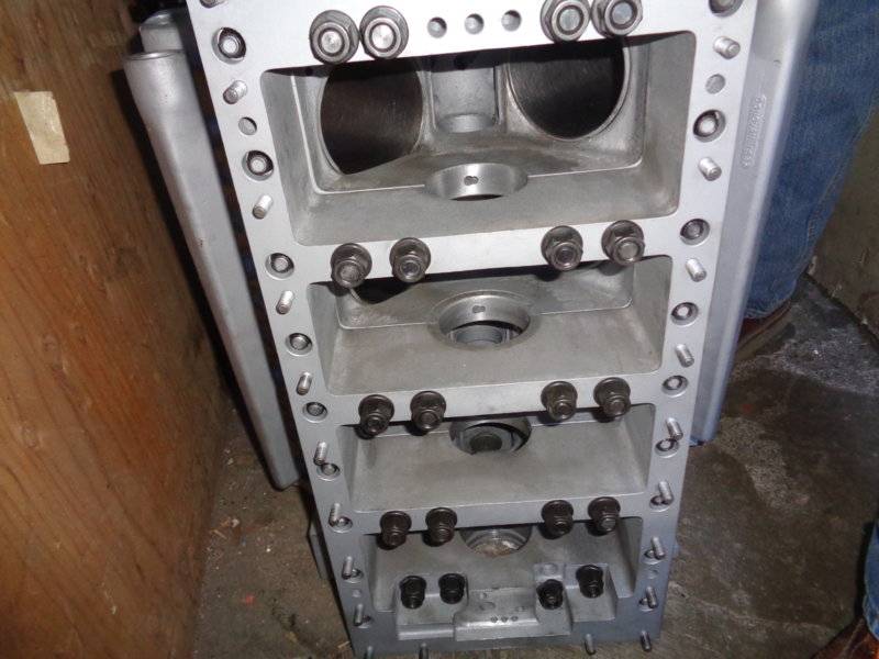

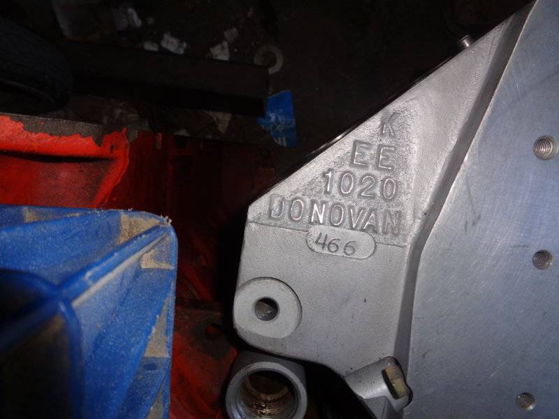

i just started my first alum hemi , i bought a donovan wet 417 block that had never been scatter in , and i'm working a deal for a bullet steel crank for , now heads . and of course all those parts to make my 1500 hp motor .
Wow, didn’t know Donovan made a wet block. I guess the tapering manifold on the side of the block is for water? Definitely a different approach.

Let's see the first Donovan I worked on did not have the outside cooling

Big cam tunnel
Looks so nice
