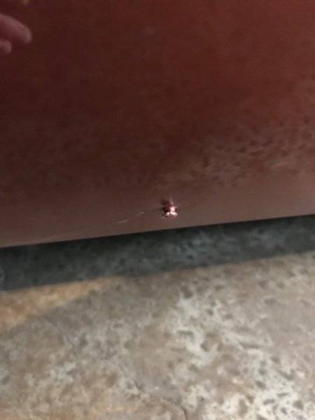

That's what I am thinking, also missing the rocker moldings on both sides and I am trying to find some or I am thinking about cutting off the little stubs and repainting the lower sill area. Thoughts?

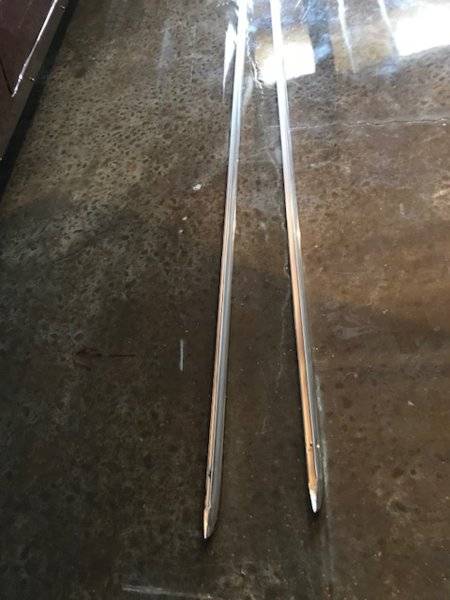

Guys, I just bought the rocker spears - molding is there a mounting kit of some type that goes aroung the studs that stick out from the rockers?
rocker panels should get rivets where plastic clips attachs, then the molding clips on them. As far I know they are pretty much the similar than vinyl top clips, however not the same
These are the ones used for halo, full and canopy roof molds. Can't tell the rocker ones ( my car got SE wide rocker molds )
Thanks but I think the Charger Ralley spears use a different method, it has 7 studs (see picture) sticking out and then the ends require one screw each.
those clips I posted slides into those studs ( vinyl top trim get same studs )... and yes, the moldings get screws on both ends. The wide SE one too.
the clips for the rocker molding must be pretty much similar if not the same to the ones I posted.
Check megapartsusa or 512restorations or R/Tspecialties
If you bought the moldings from Classic why not just ask them?
