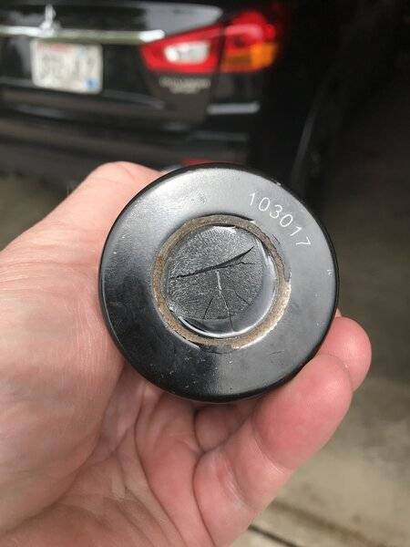

You mentioned that the MSD coil was "regulated" at 0.7 ohms. How was this accomplished? The 0.7 ohm figure was probably the primary winding's resistance. There is nothing in the coil exept the primary and secondary copper windings and the laminated steel core plus the insulation system, between the primary and secondary windings and the case with either insulating oil or epoxy. Your coil failure was PROBABLY due to the breakdown of the epoxy, due to excessive heat or vibration, allowing the high voltage developed by the secondary windings to go to ground. Once the arc path was established, the voltage will continue to follow the same path. Just my opinion of course.Epoxy and Heat - At least it didn’t leak - Just popped
Lasted one day and left me stranded about 20 miles from home off the highway last night
Four different cops stopped to say HI before my wife showed up

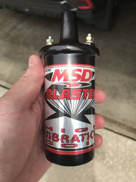

And the only reason this MSD coil went on my car was that my friend burrowed or wanted to try my Pertronix 40011 Coil after his Blaster 2 coil failed during a cruise last weekend
Yes I was running full voltage to the positive side of this epoxy filled MSD coil as the Pertronix 40011 coil requires it running a internal 1.5 ohm resistor
But this MSD coil is also internally regulated at .7 ohms
Never have I had a coil explode before
View attachment 968956 View attachment 968957
