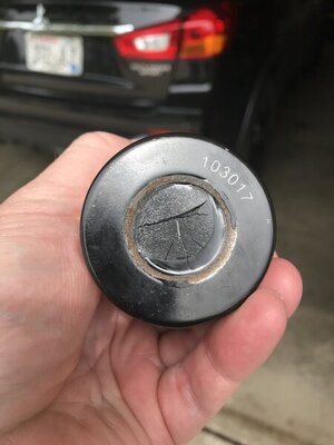

Epoxy and Heat - At least it didn’t leak - Just popped
Lasted one day and left me stranded about 20 miles from home off the highway last night
Four different cops stopped to say HI before my wife showed up
And the only reason this MSD coil went on my car was that my friend burrowed or wanted to try my Pertronix 40011 Coil after his Blaster 2 coil failed during a cruise last weekend
Yes I was running full voltage to the positive side of this epoxy filled MSD coil as the Pertronix 40011 coil requires it running a internal 1.5 ohm resistor
But this MSD coil is also internally regulated at .7 ohms
Never have I had a coil explode before
62D19511-B5E0-4863-A5A4-1EBF3BE27FB4.jpeg 1346558C-0FB1-46D8-8129-6F377E8EBA78.jpeg
View attachment 968956 View attachment 968957
You mentioned that the MSD coil was "regulated" at 0.7 ohms. How was this accomplished? The 0.7 ohm figure was probably the primary winding's resistance. There is nothing in the coil exept the primary and secondary copper windings and the laminated steel core plus the insulation system, between the primary and secondary windings and the case with either insulating oil or epoxy. Your coil failure was PROBABLY due to the breakdown of the epoxy, due to excessive heat or vibration, allowing the high voltage developed by the secondary windings to go to ground. Once the arc path was established, the voltage will continue to follow the same path. Just my opinion of course.

Just had my Pertronix 40011 1.5 Ohm Coil crack the tower plastic and around the studs for the positive and negative
Thru google search , seems to bee a popular area to crack
Coil did not fail , car still running
This one was made in Mexico
New one is made in China
Anyways , now an MSD and a Pertronix coil both cracked , i would assume from heat obviously
Ballast resistor bypassed on the backside
12.5 Volts at battery with engine not running , key in run position
14.5 Volts at battery with engine running
Full voltage to positive side of coil
