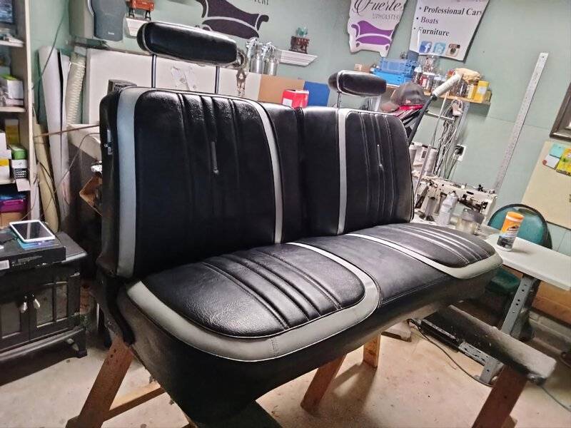

70 RR Superbird seat for my car.
As far as the seats go, that would be up to your tastes. If you want to go back to original 1967 Coronet style upholstery, you would need to find the '67 seats likely, because the frames could be different than what you have now. Or, you could order '70 RoadRunner or maybe even SuperBee seat covers for the frames you have. This is likely the road I would travel, because you already have those good seat frames. The bonus with these seats is they have head rests and the positive seat back latch, which '67 seats would not have. I would likely gravitate to the Super Bee covers, because they are not as identifiable as the distinctively patterned Road Runner pieces. Still, be prepared for a few people pointing out that you don't have the right seats in your car.

Dave6T4, I love the way the seats I have now look so I'll probably stick with those. You make some great points. Who should I order from(best deal)? I've been looking at the Spectra tank on RA but thought I'd take mine out and inspect it first. That undercoating looks like it could get in the way of removal. Love your R/T!!
Jerry, your seats look amazing!

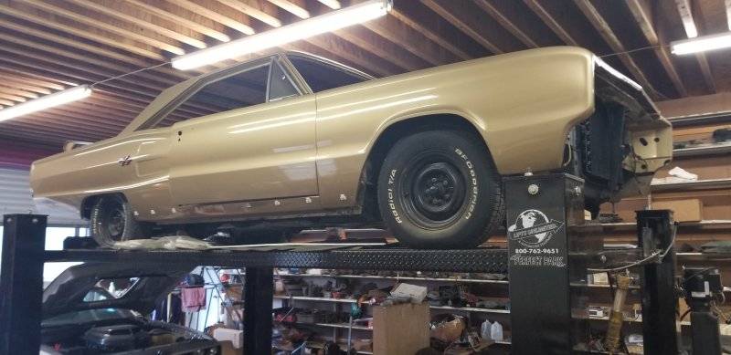

Welcome from Alabama, I haven't quite finished my 67 Coronet R/T, it's getting there. Mine has been asleep on this 4 post lift for more than a little while. Several others barged in front of it for attention. View attachment 1382237
I look at your 67 as being put on a pedestal and cherished from below.
Love that color.
