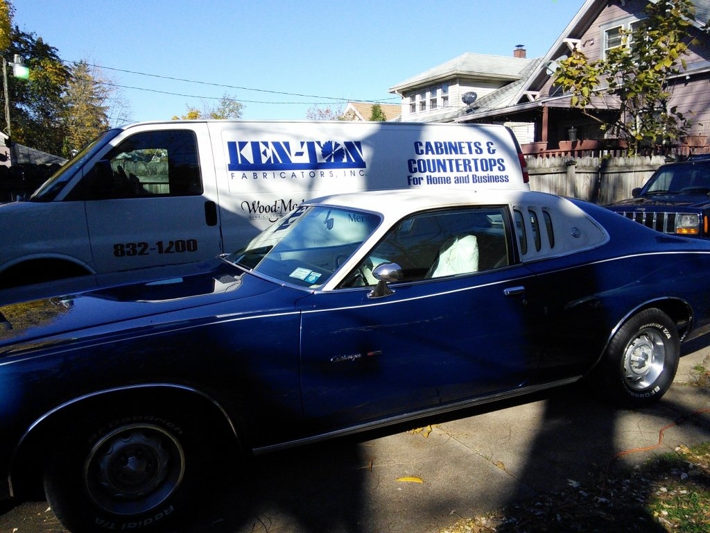

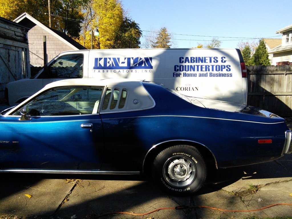

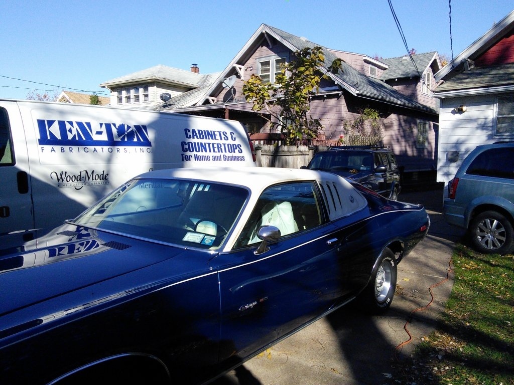

With ignition on I only have 5 volts at the positive coil. New ECM, new ballast resistor, new ignition harness under hood and rebuilt carborator. There is a weak spark. Only have 5.5 volts at brown ignition run wire under dash. Car was recently professionally repainted. (special order JB9 paint-Chrysler color) Car has only 30,000 original miles. Has been kept in storage over the past 7 years. It originally started and ran rich before repainting. It was a rust free car before painting. Body was stripped down to bare metal, epoxy coated before painting. Could it be the ignition switch? Any other ideas? Car is not currently sheltered in a garage.

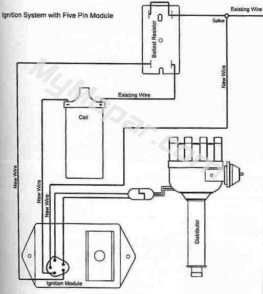

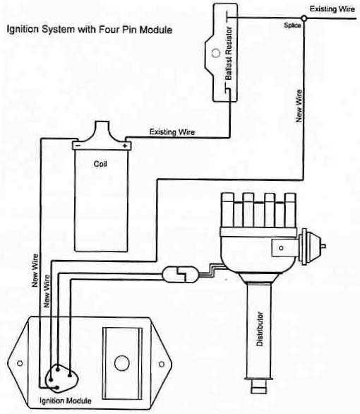

depends on what style of box & either 2 or 4 pin ballast
or if it has a 4 or 5 pin CEI controller
Chrysler Electronic Ignition Wire Diagram 4 pin Ballast & Electronic Volt. Regulator.jpg
you can get the specific wiring diagrams from
http://www.mymopar.com , under tools/reference IIRC
