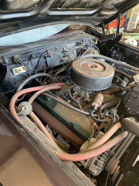

That’s an older electronic ignition system, looking at its condition, likely one reason the motor won’t run. Look at the bulkhead condition; damage from heat? Yep, ECU is bad. Bad means it won’t fire. Question is what else is wrong. I’d remove the plugs squirting some oil penetrant in the chambers and see of the engine can be turned over with a breaker bar at the crank (if it’s dead hooking up a good battery). The motor looks unattended for a long-long time. If the car spent its entire life in HI at least it never saw road salt. If the valve seats were never replaced to run on unleaded gas and it was run like this or not using an additive – another issue.

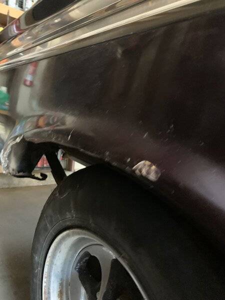

I’d pull up the trunk liner and see what the pan looks like. If the inner quarters are exposed (some had liners) good to take a look there to identify the extent of rusting. Having a CA ’63 vert, the truck pan and a section of a quarter were pitted needing new metal. The nifty side trimming on these cars can snag water and can rust around this area. If exposed to salt x 10. I’ve invested over $35k restoring my car and about half that was done by me. I paid $5,500 for mine back in ’95. A BB SF never seeing road salt for the price being all there is a nice find IMO. But, a nice resto isn’t cheap…depends on if you want a ready driver or some work and spend cash to make it happen. In my case, I know what I’ve put in my car is well beyond its value; but wanted this car to be for me the way I like it.

Well, that’s partially true, it did not see road salt , but air is salty - cars next to the ocean are rust buckets

Yes - have heard that; but after restoring two vehicles that went through many WI winters I'll say the undercarriage of the car looks dang nice. I can send a photo of what what a frame looks like I recently undercoated after a few days of descaling, wheeling and blasting...lol.

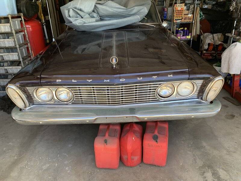

Thank you for the help and information everyone. Looks like that this fury in nor for me, he’s firm on the price and there’s more body than I want to do. I went there to look second time and took my time, found what it looks like old body damage on the driver side and hood/fender/door cannot lined up. I notice 1/2” gap first time I was there, but I thought it was just worn hinges. Anyway, with all that it’s not worth 10k, search continues.
