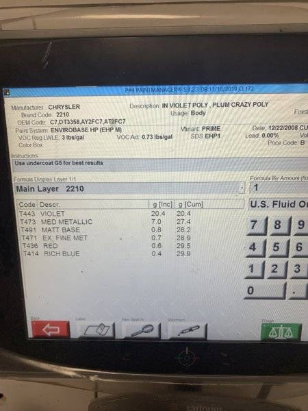

Ppg 2210 can still be made.

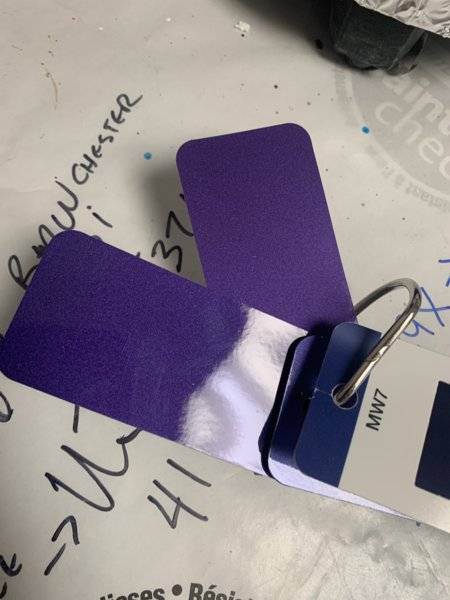

It may but it takes a special toner on the new PHG plum crazy. Heres to chips.
Ill say maybe more vivid.
