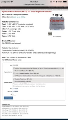

This is the champion radaitor, says no support for factory shroud in the description.
If you want a shroud I'd look at the radiator @threewood is using. My road runner had a champion radiator and no factory shroud would fit.
