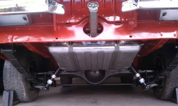

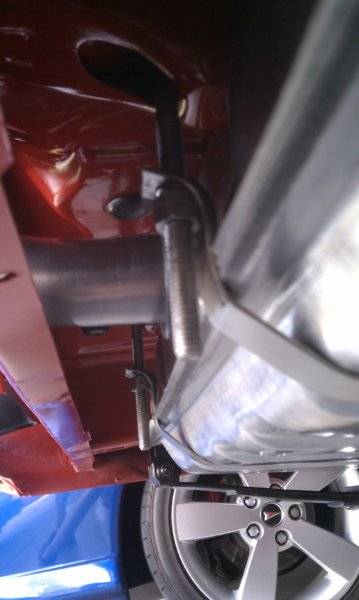

Here are the j bolts and tank straps if you need reference for these.

Couple of Images just to update the thread
C01EED7F-CAC6-49B0-9294-CB3D7ABE88C6.jpeg 13EA0073-3303-4245-8900-FC3D5713E687.jpeg

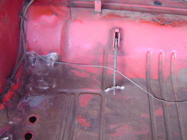

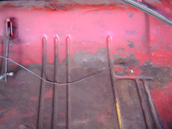

The sending unit wire comes off the rear tail light harness and goes over through a grommet down to the tank. Here are a couple of pictures from before my restoration show the wire, blue, coming off the harness and over to the hole in the trunk floor.
Thanks again. That’s the way I ran mine last night. But kept up up there the jack brackets are then brought is down. It was the only way I could see with that grommet being right over the sender.
I was wondering was there a neater route from the factory, but doesn’t appear so.
I agree its not the best way to have that wire run, but once you have a trunk liner or carpet installed its not visible.
