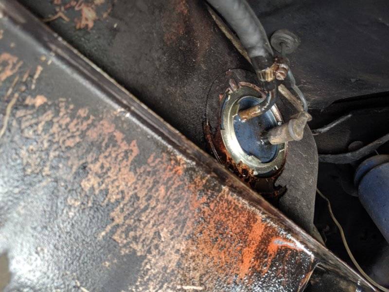

Also just noticed the gas tank is leaking from the sending unit. Ordered a new gasket, hoping that fixes it!

Gas could also be coming from the solder joints where the tubes go into the sending unit plate but I would try the gasket first too. It may just be out of position.

If it the welds, do I just need a new sending unit?

What they said on the wiring. I hate wiring issues. On the tank leak, if somebody replaced the sending unit, there is a good chance the aftermarket lock ring is the problem. Most all of them are junk! If that's the case, the ONLY good source that I know of for a replacement is either a good original or Bill Rolik.

If the gas tank has been replaced, the sending unit lock ring that comes with repro tanks SUCKS, that could cause a leak.
I had that issue but not with the lock ring itself but the ring welded to the tank!!! so I had to lock it gently to not bend it ( the piece welded, not the ring )
Yeah I am not sure if the tank is original.
Did you have to get the tank ring welded?
I just used the OEM lock ring that was on the old tank I took off.
The repro ones are too thin and they don't crush the gasket enough, and that lets them slide around which then could cause the assembly to leak.
Ah yeah, I don't have the original so I ordered as new gasket that is supposed to be thicker. Also bought some multimetal sealant to have ready if the sending unit itself is leaking.

the repro lock rings also flex and can bend real easy- a radial bend that makes them conical.
Best solution is find an OEM ring.
there was a FxBO member selling them a few months ago.
Hey I decided to take a short video the leak. After watching it for a second it actually looks like the line is the part leaking. What do you all think?
I attached a picture of it since the video is too big. The rubber hose looks a little damp like it could be leaking.
