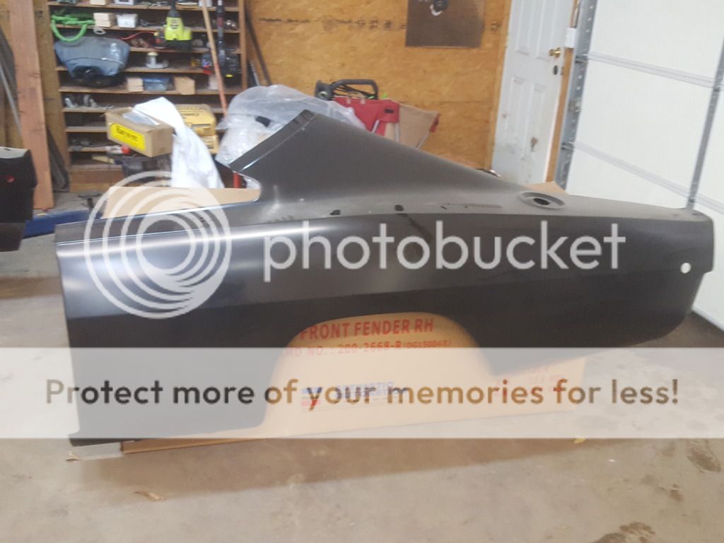

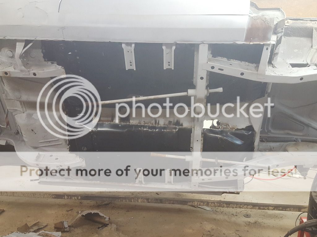

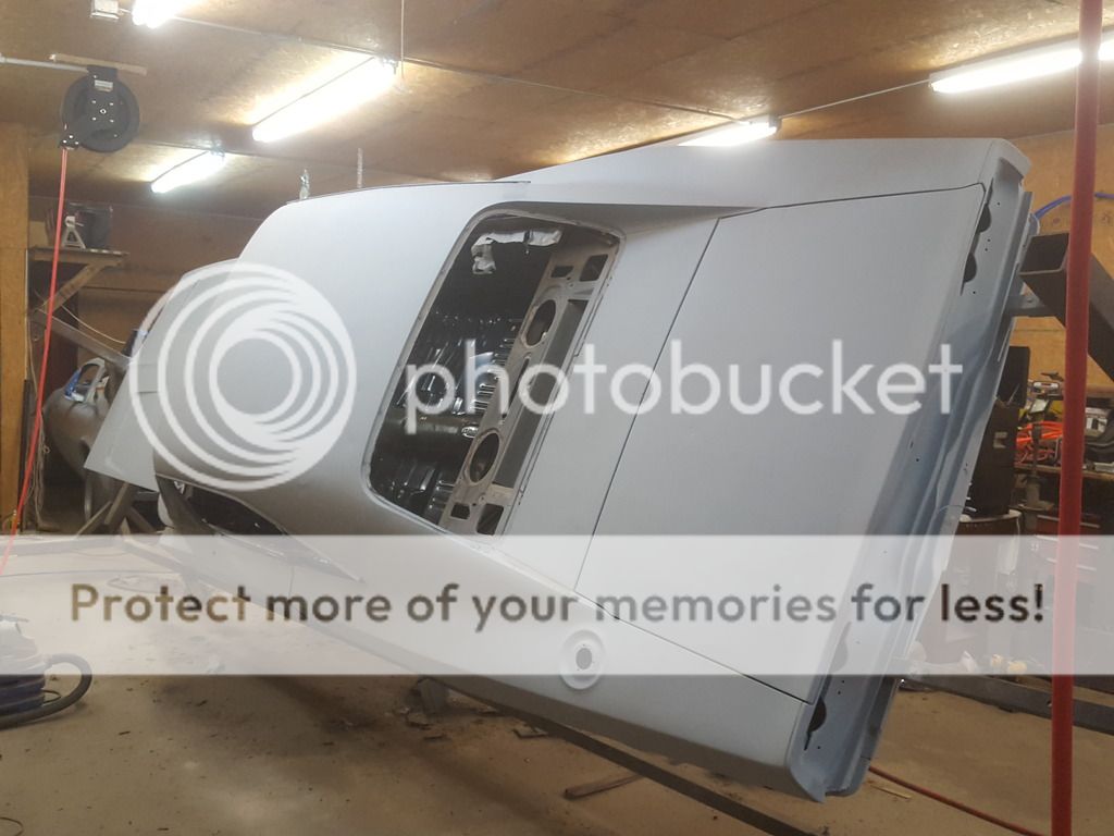

been slow going but I do have a few updates, I dropped the idea of the 6.4 due to the cost for the relatively few HP. I went with a brand new built 512 stroker and a TKO 600, reilly motorsports alterkation full adjustable front suspension and K member and his 4link kit for the rear. Both ends with adjustable coilovers. all the bodywork is very close to being done. Just making the gaps perfect takes some time my body guy said. any idea how wide of a tire I can stuff in the rear without worrying about the leafs?
Since your going 4 link, leafs are gone. Might as well relocate the lower links inboard and narrow the rear for some beefcake tires!
