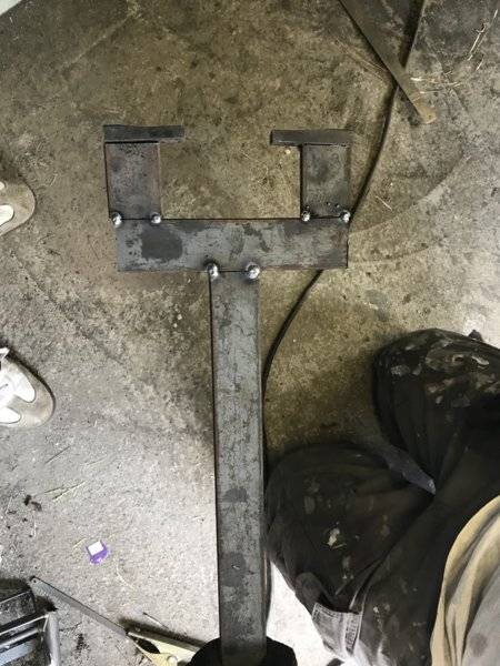

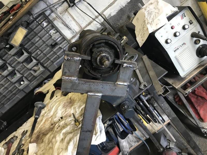

So retaining ring on my steering box wouldn’t budge to do the rebuild today. They where crazy tight, So I made myself this out of some scrap lying around.
Fits both retaining rings and works a treat.
Pardon the welds and poor prep. Was a quick solution and ran low on welding gas.
