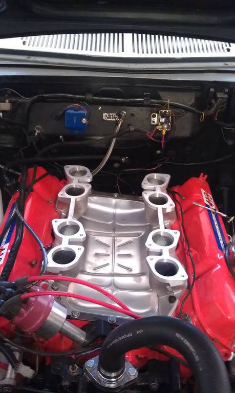

HERE ARE A FEW SHOTS OF MY NEW WEBER CARBURETOR SET UP FROM MY WORK PIERCE MANIFOLDS HAVE ANY QUESTIONS SHOOT ME AN EMAIL,
Those look awesome! How much were the manifolds? Are the carbs set up at least close for your application? Once it's dialed in it will run great.

the setup all together is about $2200.00 at Pierce Manifolds right now, with the manifolds around $500.00 for the pair. trying to get them on the market and get feedback. it runs way better and harder than the 800 cfm edelbrock and rpm manifold.
I saw your 63 Wagon at the mopar show this weekend. You got my vote, that thing is awesome and we were really liking the intake and carbs. My brother grabbed one of your cards off the windshield. Personally I think it's a great lower cost alternative to fuel injection stacks. Nice work!
Also to note that IDF's don't have a power circuit. Have you had any issues with it going lean? IDA's would be the ultimate but are horribly expensive last I checked.

I built this motor 6-7 years ago with a roller cam using an 800 cfm carb. But it runs great with the new IDF set up. Great throttle response and power. Way better than the 800 cfm Edelbrock had.

The set up is available at my work Pierce Manioflds in Gilroy Ca. We do have a website, not sure if I can list the site here dont want to break any rules. The whole setup right now is $2200.00 for what you see in the pics. Not sure what MW ports are but they do fit 383-413-426-440 heads. Top end is awesome, blows away my 800 cfm Edelbrock in all areas. We are currently working on getting this setup on our website. But please anyone who is interested give us a call 408-842-6667
