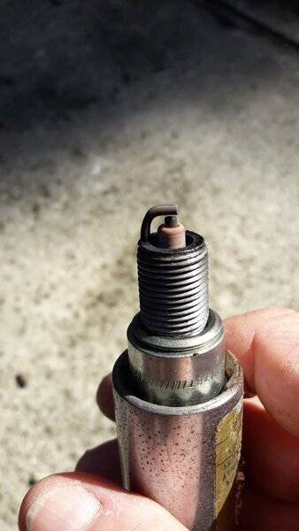

I’d check the plugs as others have suggested. Sounds like way too much fuel or not enough timing.
I have a 340 in my B body and it does amazingly well on gas. I switched to a Quick Fuel 650 a few years ago…had a Demon before that.
I didn't have much time today but I pulled the plug from #1. It looks ok to me.
David
