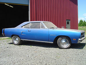

Hey so i saw a 1970 sport satellite that is a column shifter and i wanted to purchase but thinking about the price and car insurance needs. The guy wants $8,800 for the car when i inspect what should I look for?
I will review the basics and look for leaks & rust and other things but i was wondering if there is anything specific to these cars that i need to look at.

looks clean from that pic..LOL
That car was just sold on e-bay. Were you the winning bidder? I spoke to the seller. Not the original drive train. It was replaced with a 383 engine and a 727 trans. I would check that thoroughly. The seller claimed it was pretty clean, with minimal rust, but again, check it- frame rails, trunk, floor pans, etc. Insurance from Haggerty for that would be about $200 a year.
