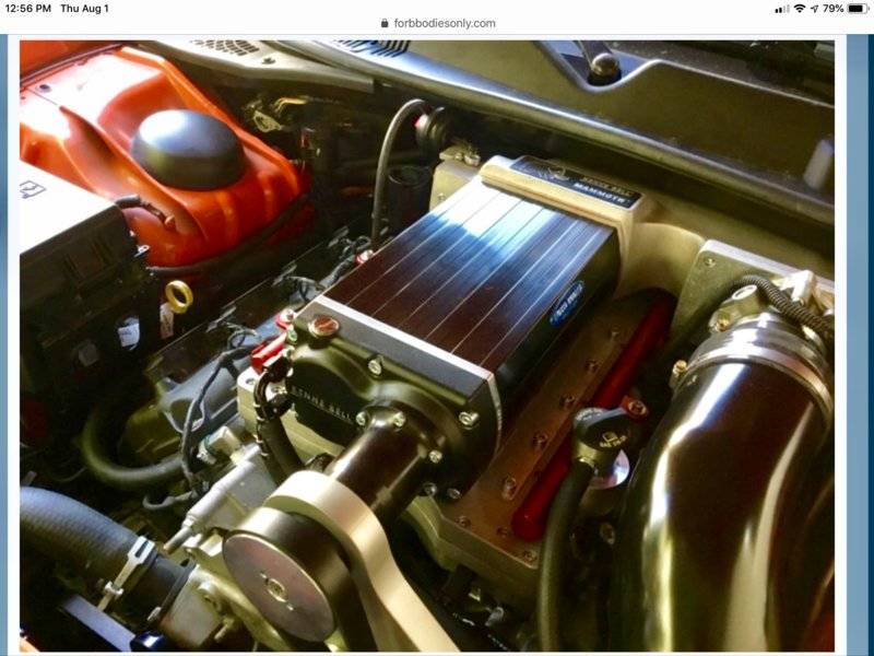

09 R/T TRACPAC. Liking the Blower, but that eats about 8k right here. Kennel Bell 2.8 L liquid cooled twin-screw. Added about 100 hp. Just right.
