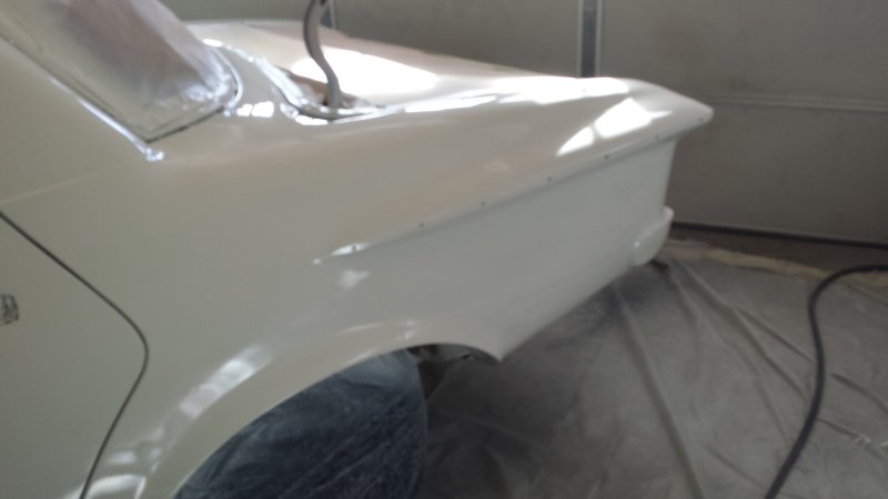

My friends Ford is painted with Summit base/clear, it laid down nice and seems to be holding up well…
5 qts sprayable. 3 wet coats no engine bay or door jambs. Had almost a pint leftover.

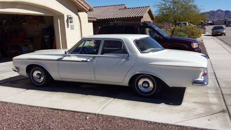

I only painted it a year and a half ago so can't speak of durability but here in Phoenix even the best paint won't hold up long outside. Mine are always stored inside after being painted. I have a regular customer who has me paint a car for him and then he never gets around to finishing them up. Two of them just sat out in the sun and even though they were painted with top of the line PPG they went to Hell in about 4 years. Any car with a nice paint job should not be stored outside.

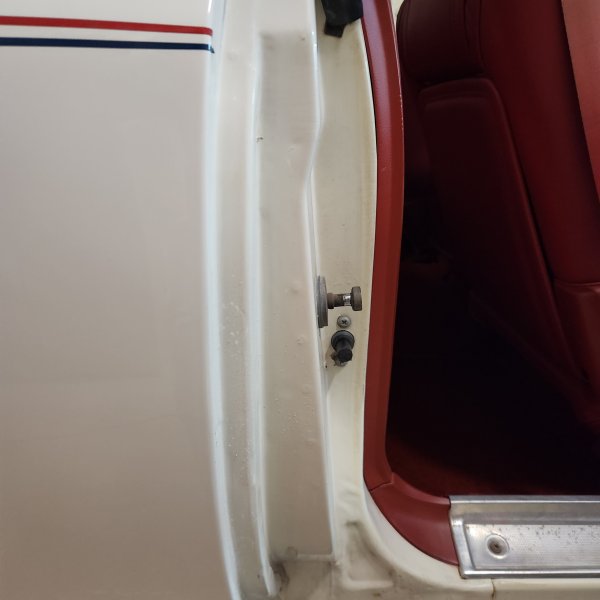

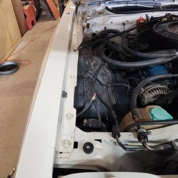

One more question. You said you did not paint the door jambs etc. But how well/ close did the Restoration shop paint match the factory Spannaker White ?
You can tell the difference but the 45 year old paint is definatly faded and yellowed so matching it probably isn't possible. I'll get a picture in a bit.
Actually looking at it it looks pretty close. Not sure if the pictures show it but it's hard to tell the difference.
