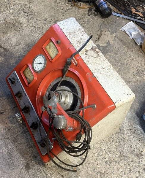

I've always wanted a distributor tester. The Sun units can do a lot more, but they are huge and too pricey for my beer budget.
I found this Rotunda on market place. Gonna need some work, but the price was right and it's relatively small.
I was taught how to test and “recurve” distributors on that exact model. I’d love to get one for my workshop and your post reminded me that I need one. I got an AS degree in automotive technology at Citrus College in Glendora California along with another AS in Applied Sciences. I bought a recurve kit or two for my Mopars that came with different weights and springs. Thanks for reminding me!
I'd love to find a schematic/parts manual/operation manual for it.
I saw it had a paper capacitor in it. I want to change that before I light it up so I don't roast the vacuum tubes.
The housing clamp was froze, I just got that freed up.
The vacuum pump belt is loose, so I want to tighten that.
The motor and speed adjuster spin free, so that should be fine. The vacuum gage reads +/- 1"Hg on 2 other gages.
I'll keep you guys updated.
