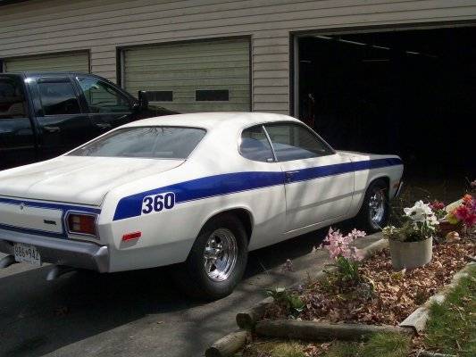

My brother built this mild 360 Duster to cruise the streets with and hit some local cruise nights when I do. Its a mild 360 with a solid flat tappet cam around .520 lift and like 242 @ .050. He ported the heads pretty good himself and has 10" Turbo Action converter in it. He did not plan to race it but he decided to make a few passes in it the other day. He is useing M/T drag radials and ran 12.11 @ 111 not hooking real good as it was street night and they did not treat the track. But heck with a little tuning it should go high 11's. He did not build it to worry about how fast it is but it does run pretty good. Ron

Nice duster.....I'd have to look 2X's or more at that ride!:sunny:
very nice job.
Since I had a cousin with a `71 Demon 340 and I had a `70 Duster 340, I have a real soft spot for the `70s A bodies. Nice job 383man!
Cool A-Body 360 Duster "Street Car", I'd roll in it...
12s by accident?
Smells like victory to me.
Oh yeah ! ! love that color combo looks sick "More Pics !!"
That's fantastic! Sounds like some serious bang for the buck going on. I love it when that happens.
Nice looking/running package. Would look real good with some nice stainless tips out the back!

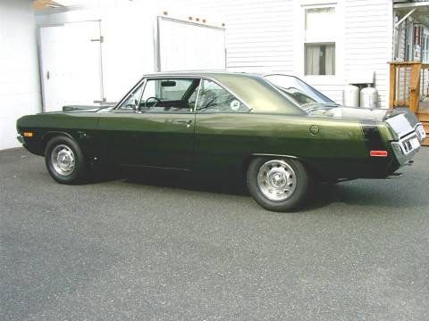

I agree as I like the more factory look with the stock rectangular chrome exh tips like I had on my sons Dart you see here when I built it years go. But my brother dont care as much about the factory look as I do.
Thanks for the kind replies. I dont have any more pics but I will try to get some. Ron
