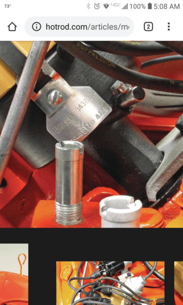

This is from an article about restorations that Frank Badalson did.

A true OE restoration, whereas an OE car is judged by the David Wise book, specs that the fittings are installed in the water pump before paint but have "tape" marks halfway down. So not bare and not painted, everybody is wrong! Or right, per each individuals ego.
