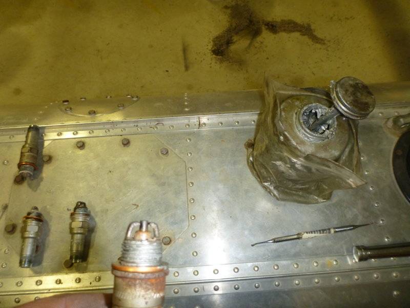

A little dab of "I'm a tin man" and fresh soft copper crush washers with every install.
It serves two purposes. 1- it keeps the metal plug from seizing and ruining a $$$$ aluminum cylinder head and 2 - it works as a heat sink paste to keep your plug and cylinder temps uniform with each other.
