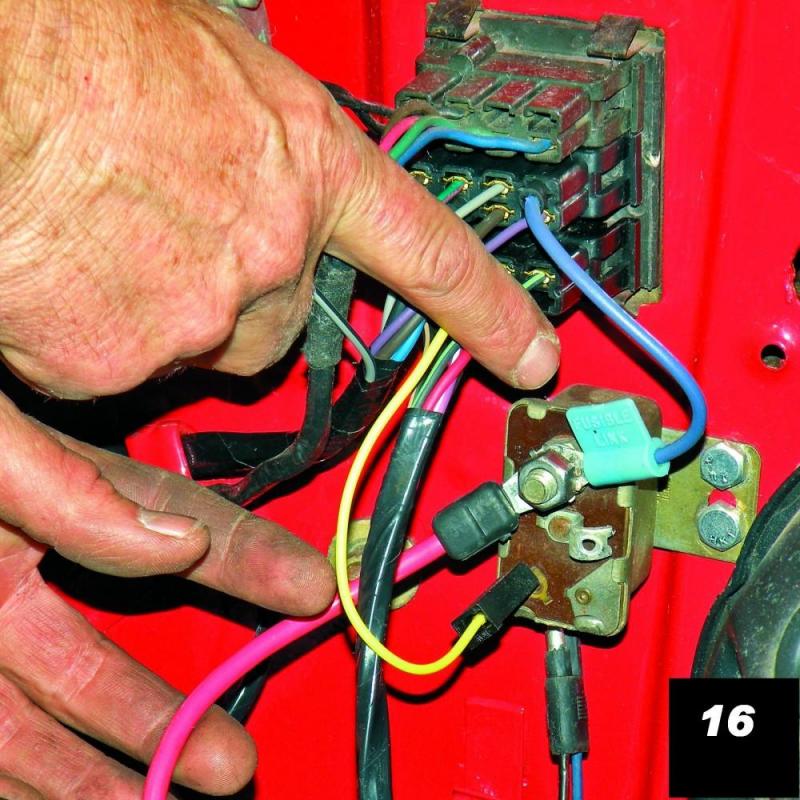

K just checkin, out of curiosity what does the fusible links look like at the bulkhead connector? Also, on the fuse block under the dash, there's 1 fuse/connector missing at the bottom labeled "battery/alternator" and don't see anything goin to it.
This may not be exact for your car, but the link looks like this blue wire: 277231-1000-0.jpg
That looks similar and a lot nicer than mine. I dont think mine has any wires with fuses.
