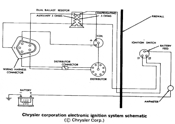

Whos electronic ignition?? Maybe a review of the wiring schematic or put up some details of the conversion?
If you have an orange box, silver or the blueish one they are pretty simple to wire. Got this info from Daves place. HERE
Hi. Seems my problem is before

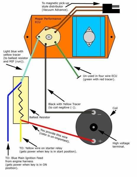

Check out the drawing on the lower portion of my post. Make sure you have it wired as shown. You need to add a jumper wire from the ballast resistor to the pos side of coil. As well as the yellow wire from the starter relay. So if you do not have a dual ballast resistor and just have a single you will need a dual male spade adapter to add the coil + wire. Those terminals look like this.
Sadly with limited information about his setup its hard to figure out what method of wiring he has.
I'm thinking your set-up is a brown wire (from ignition switch crank )here, instead of a yellow one?? In this particular schematic, to use an MSD ready-to-run, the yellow and blue wires both (tie together) go to 12v + side of coil.
View attachment 857770I'm thinking your set-up is a brown wire (from ignition switch crank )here, instead of a yellow one?? In this particular schematic, to use an MSD ready-to-run, the yellow and blue wires both (tie together) go to 12v + side of coil.
This is correct. Had to do this when I installed an MSD RTR in my friends GTX
