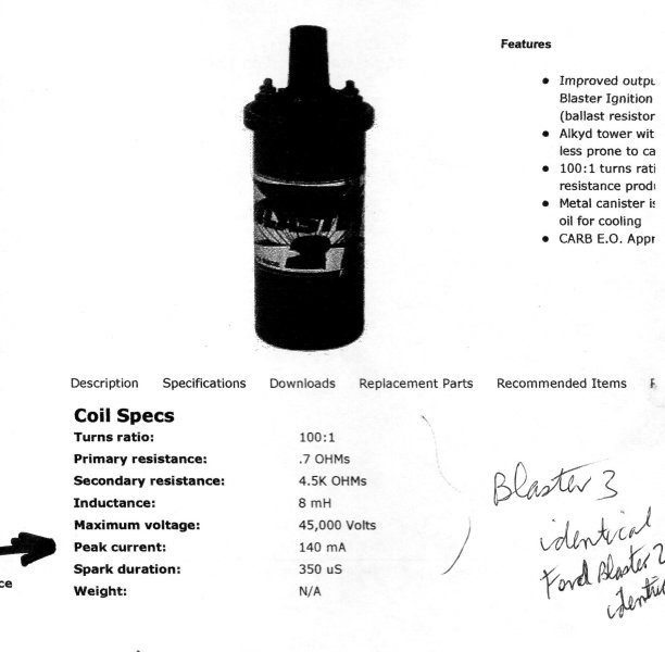

The only time current flows in the secondary is when the actual spark occurs...its NOT a range as noted by 600ma to 2 amps and it's limited by the impedance of the coil's secondary resistance AND it's core loss or I2r loss. How do you know the peak current is...did you measure it or that's what the advertisement said? How did you measure it? Sounds like guesstimates......not actual facts.....Bob,
The only person who is uneducated about the efficiency difference between a canister coil & an E core coil............is YOU. Find some PROOF & post it that claims that a canister coil produces a hotter spark.
The heat in the spark is what ignites the A/F mixture. That heat comes from secondary coil current.
The MSD Blaster 2 & 3 canister coils have a 140mA peak current.
The MSD Blaster 8207 E core coil has 300mA.
The high power MSD E core coils have sec currents ranging from 600 mA to...2 amps.
