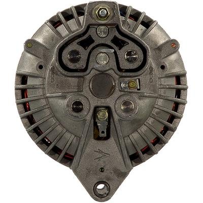

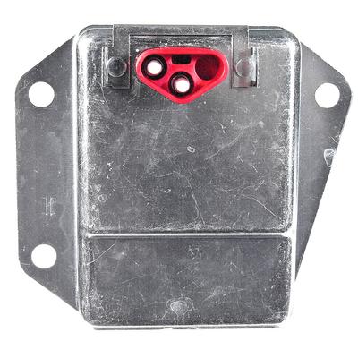

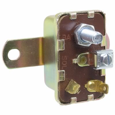

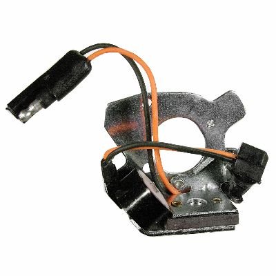

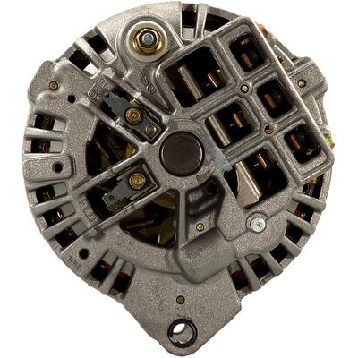

This might help some maybe... Make sure all the connections are good, Make sure you have a good engine to firewall/body ground, add a ground strap/wire w/star type washers at the back of the head or intake, to one of the ECU controller mounting bolts, will also help to shorten the path for a good ground, saves coils, controllers, magnetic pick-ups, in the long run too... I also always run a adequate sized #4ga. 0r #6ga. ground wire from the alternator body to the chassis/body inner fender-well ...You can also add/run a #8ga. or larger wire from the main charging 12vlt. out-put 1/4" threaded terminal on back of the alternator, to the main large 1/4"-5/16" threaded terminal on the starter relay , it helps by shortening the path of the charging system, instead of having to go all the way thru the AMP gauge, then thru the under dash wiring {the large black wire that is branched everywhere , under the dash, from the bulkhead connector to the Amp. gauge etc.} than out to the starter relay, the wires under dash can still remain in place too.... Try www.MadElectrical.com there are some great electrical repair & tech. articles & parts available there too... Oh yes make sure you have a proper air-gap between the distributor star reluctor & magnetic pick-up coil, around 0.008", make sure you check with a non-magnetic brass feller gauge...
