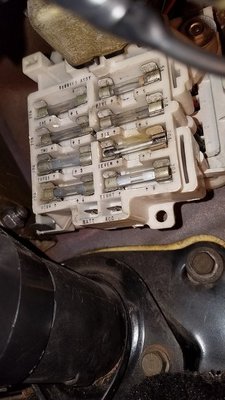

My buddy told me I had no brake lights I checked the obvious all the lights worked in the back. I figured it was the stop lamp switch so I replaced it still no brake lights. I checked power in the connectors with a test light and still nothing. I replaced all the fuses on the left hand side 1,2,3 and 4.
I traced the wires as far as I could go up to the hazard flasher they work no power to the ciggerette lighter also. I'm at a stand still can't think straight any more. If any one can help me I'd appreciate it.
Thank you Doug.

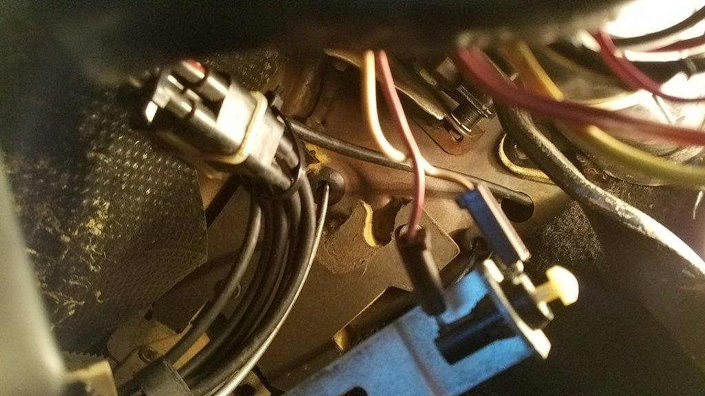

View attachment 430211 View attachment 430212
The switch you see is the old one I haven't installed it on to the bracket I just have it plugged in
I think the power comes from the turn signal switch, I may be wrong though. What kind of car is it?
Two wires go to the brake light switch. One of them, when the key is on, should be hot.
You might check that...if no power, check where the wire gets it's feed from. One wire, maybe the white, is power, the other goes to your tail lights.

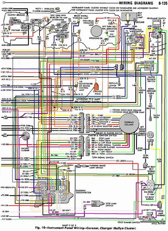

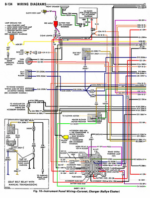

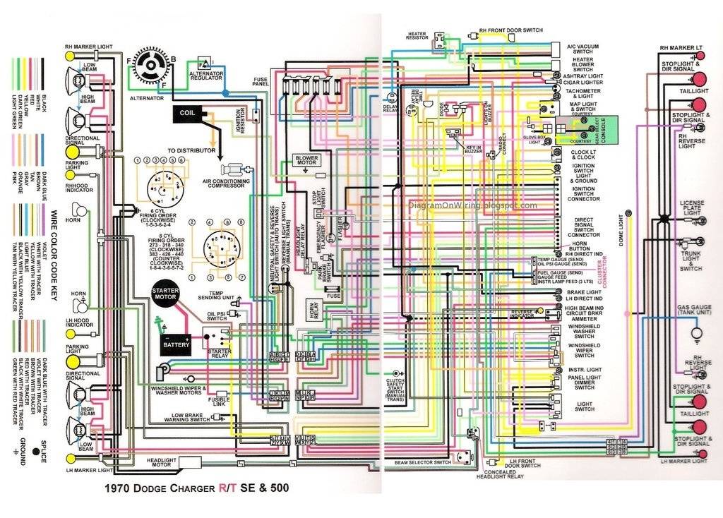

Looking at the schematic you may want to check your column harness connections, saw a 70 schematic that shows the break light switch is for the ground, not power...
underdash_rallye73a.gif underdash_rallye73b.gif Complete Wiring Diagram for 1970 Dodge Charger RT SE and 50.jpg

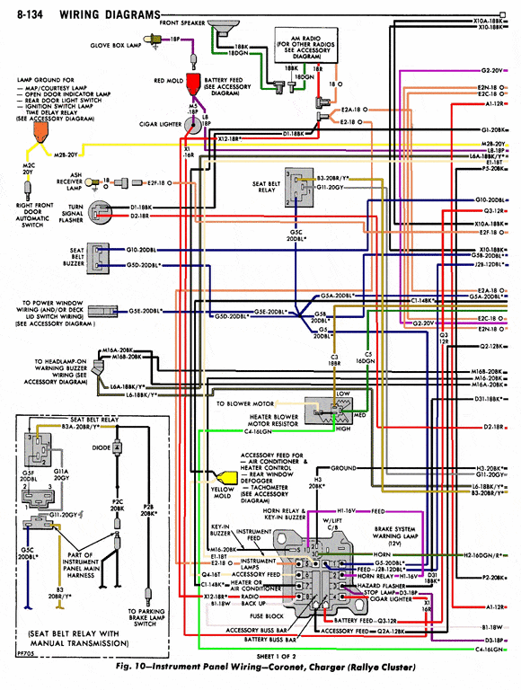

This is the power route:
Fuse box ( batt power so allways hot )
Pink wire at brake pedal
Pedal switch
White wire at brake pedal
White wire at turning switch
Turning switch
Dark green and brown coming out from turning switch ( if turning switch on rest position )
Same colors up to tail lights, one to each side
Turning switch changes the source coming from white wire to rear lights depending of function selected. If left side is activated, just right side gets the power from white wire and backwards. Turning flasher feeds the turning switch throught red wire to it feeding the side selected.
If hazzards are selected, no one side gets the power from white wire coming from brake pedal switch, but pink wire which comes from hazzard flasher
I found the problem the white wire coming from the column into the connector had backed out I traced it with my test light and found it. I pushed it back in and now I have brake light's. I really need to get rid of this old wiring and up grade it. Thank you every one for your help I was losing my sanity trying to figure this out you guys are awesome .
