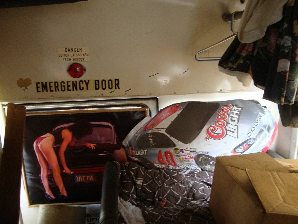

belvy1, lov da avatar , View attachment 439206
Is that the inside of an old bus? Super cool!....to the OP, a general rule of thumb for stall speed is to be around 500 RPM over the bottom of the powerband of the cam, and your a tad over that, but not bad..again compression and vacuum test will tell you lots...could even be something like a distributor advance problem
