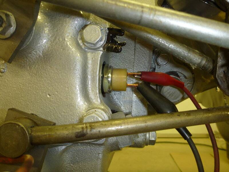

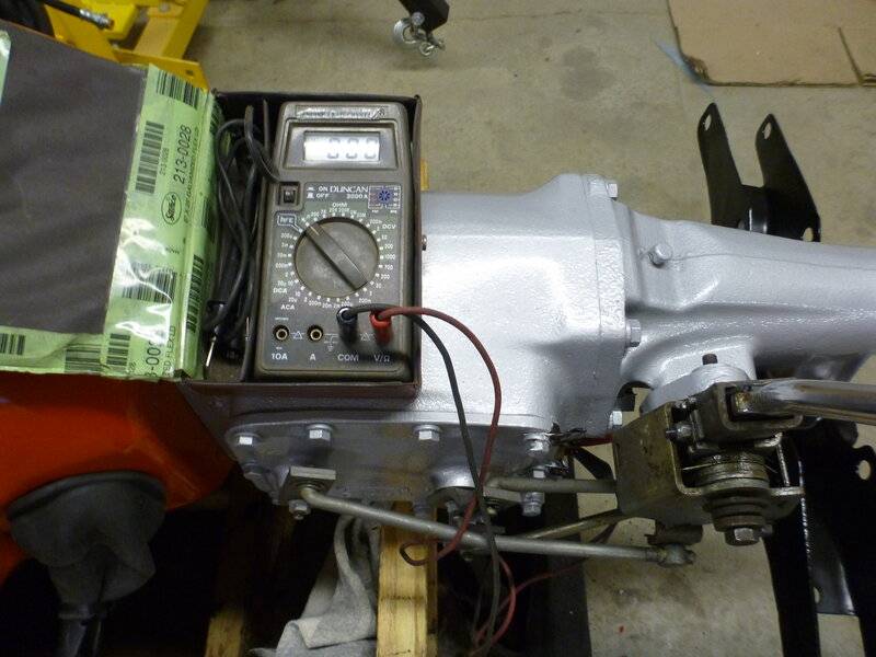

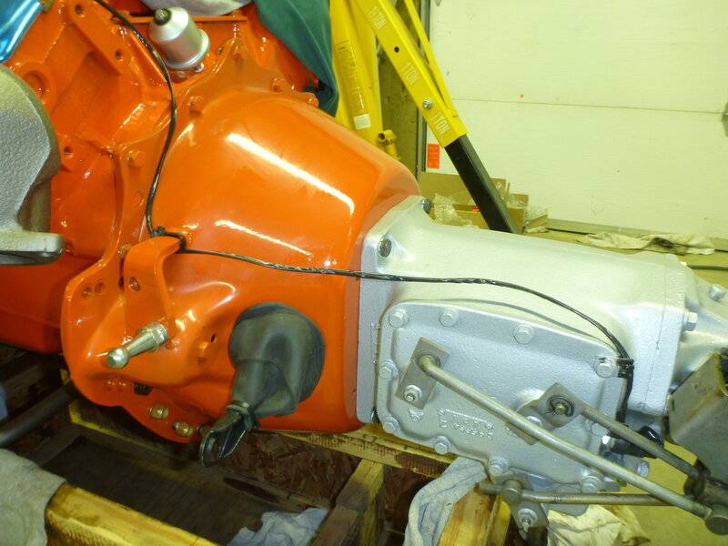

Neutral safety switch on a '70 is on the pedal... has nothing to do with the light. Reverse light switch is on the end of the case, pull the plug off and jumper the connections IN THE SOCKET and see if she lights up with the key ON. If not put a meter on the switch and see if it's toast..

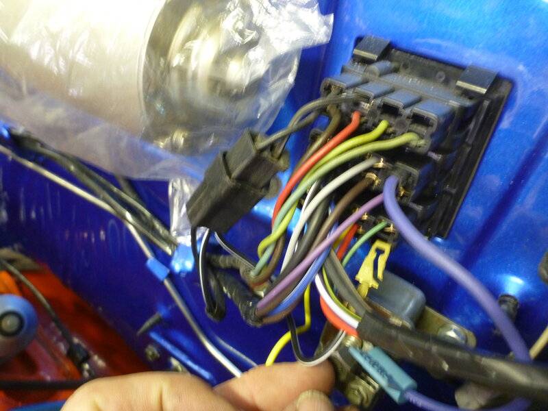

Quick check without getting under the car Dave... Disconnect the two wire plug at the firewall bulkhead and jumper the wires there on the bulkhead/wiper motor plug end.. do you get reverse lights again? Heck you don't even need to disconnect it, just take a wire and jam it into each wire spade.
well I jumped the wire and no dice. I know all 3 bulbs are not bad. I used a test light last and no power off of bulkhead. New dash harness so I cant see it being the wires. Any clues? I cant see Reverse having its own fuse in the fuse box.
