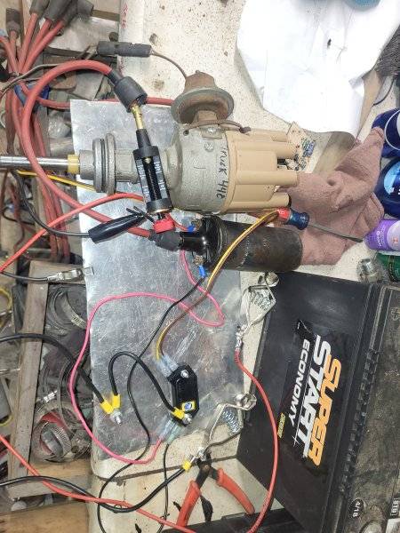

This is my set up. Once it works I will tidy up my wiring.
When I hooked it up and tested it there was really nice spark, but a spark jumped from the coil - to the aluminum plate. Then no spark.
Aside from it not being neat and tidy, do I have something wrong?

Your ground wire that you have. Looks like it runs off module to another mounting point. Does that ground the plate your module is on? And the model is actually mounted to that plate? I ask becuase ground MUST be tight and secure . I always like to have the mounting screws threaded into the plate the module is on.

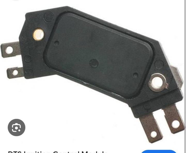

This is an LX301 By SMP. Notice the dedicated grounding eyelet and small tab that protrudes off the side
The ground wire from the module uses the same grounding point as the wire that goes directly to the battery, which grounds the plate.
The module is screwed tightly to the plate with the goo that came with it.
