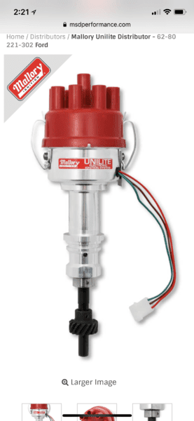

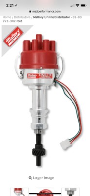

so it is an electronic distributor like this one

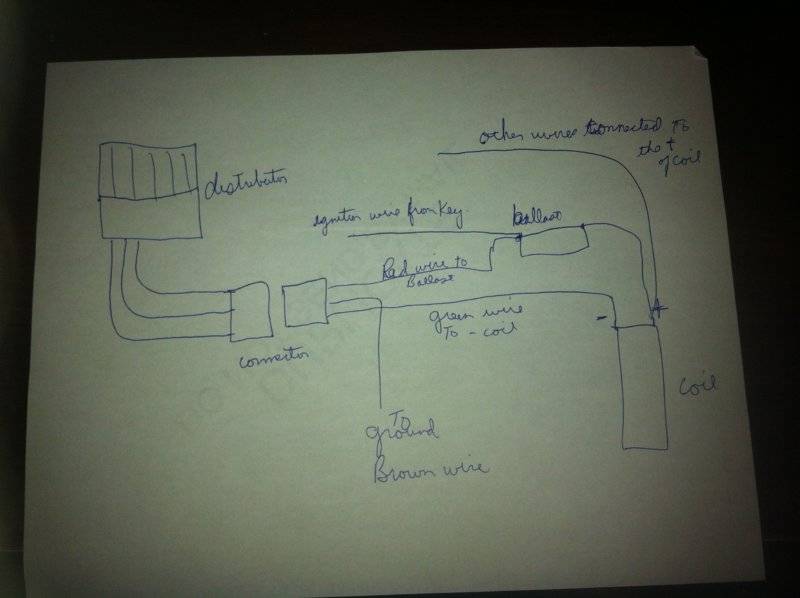

Sorry for the crude diagram. Click on the diagram to make it bigger so you can see it better.
Do you have it wired like this? If you have 12 volts from the ignition switch you have to use a ballast resistor or it will DESTROY the ignition module in the distributor.
