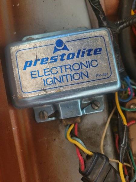

All I did is change the spark plugs. Now I have no spark. It's an old Prestolite electronic ignition with an accel super coil,that's how it came. Measured voltage at coil 12.5V on + 9.8 on distributor side. Primary resistance is dead on spec, secoundary resistance is a little high. No fire on coil wire. Any help would be appreciated.

Define prestolight electronic ignition. There are two CDI and a add on kit.

The only Prestolite "electronic" ignition system I recall Mopar using was the unit that was optional with the middle 60's Hemi and MaxWedge applications. The one I remember wss a large unit that was mostly a finned heat sink with the switching transistor on it.....but it was triggered by the points distributor. I've seen the module shown on a few industrial applications (fork trucks running propane) and some early, mid to late 60's AMC ...... AMX & SCrambler......but that's a long time ago.......Just talking out loud........

I wouldn't be surprised if it did come of an industrial engine, after all it does have 2 different heads on it.
