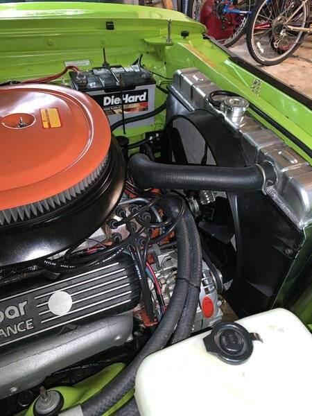

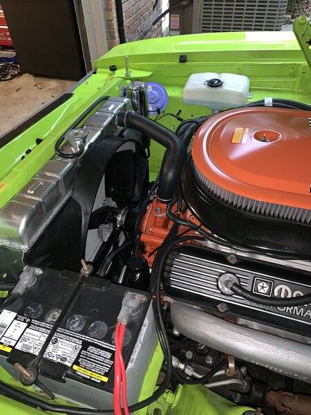

After all the pain and suffering, new radiator (s), pumps, thermostats, housings, hose springs, shrouds, mechanical and electric fans, and countless failed test drives in 90 degree heat, my high temp problem was a $2 auto meter sending unit. Ugh.
The good news is my cooling system is stellar. Converted small block radiator and housing to big block, new US Radiator triple pass unit, OEM mechanical fan, and new reproduction shroud. It made me do what I needed to do I guess. Looks sweet and OEM!

Nope. I think it would hit the hood air grabber not the actual air cleaner.
