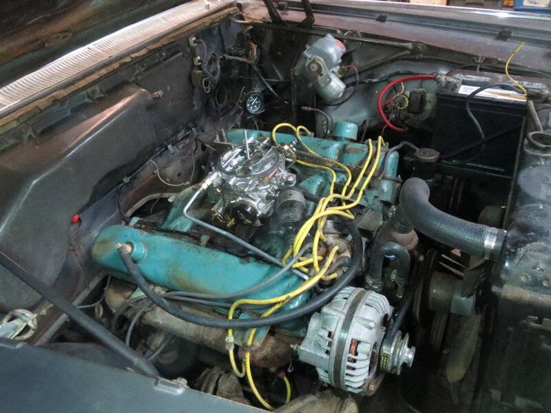

No problem. I’m just trying to get the low down on this new engine. My imperial runs good too. I sent the carburetor out for a complete overhaul. It leaks some oil from the rear main and front oil pan seal. Not bad though. Maybe 1/4 quart in 2000 miles.
I am still astonished that it hasn’t leaked a drip from anywhere since I got it to run back in November ‘19.

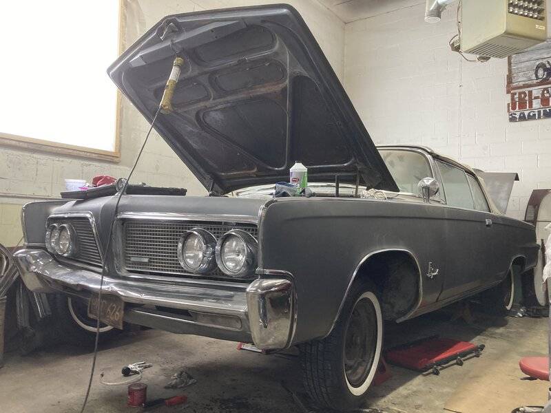

Mine didn’t either until I took on I10 through the desert for 300 miles at 100+ degrees. Nice car. Does your auto pilot work?
Thanks and I actually removed the Auto Pilot because it interfered with the new dual res master. After I got it running after at least 11 years of storage I went about replacing the brakes and a majority of the front suspension along with starting to tackle getting everything working inside like windows and such. It’s rust free with the exception of the interior floor pans which I got from a donor car at the same time I got a whole donor car for one of my ‘67’s so this one went on the back burner since then.
All of my windows work (even the wing vents) along with the power door locks, antenna, and six way bench. All the lights work too. Even the ashtray light.

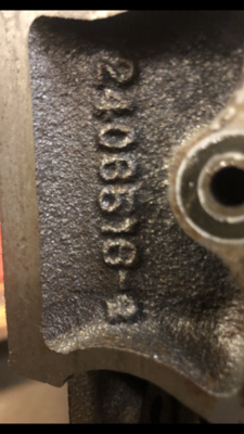

Sorry Jonpaul, I missed the original picture, what a dork I am!
Sounds like the 413 you have is a very trick piece of kit indeed!
Adjustable rockers and solid lifters, wonderful stuff indeed.

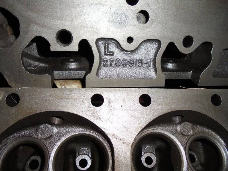

I would try and find a set of 1967 '915' heads for such a rare and unique engine!
If you was closer I would send you my spare set, that I have on a trick 440ci.
'516' and '915' are Chalk and cheese when it comes to Mopar IRON!
Its 'grocery getter' compared to 'supersonic-rocketship' lol:steering:
Unfortunately the 516 has small Ex-ports and even a smallblock exhaust valve!
The 915 casting was and still is the best Mopar 'iron-head' ever made.
Spending money on a 516 is 'money down the drain' in my opinion...

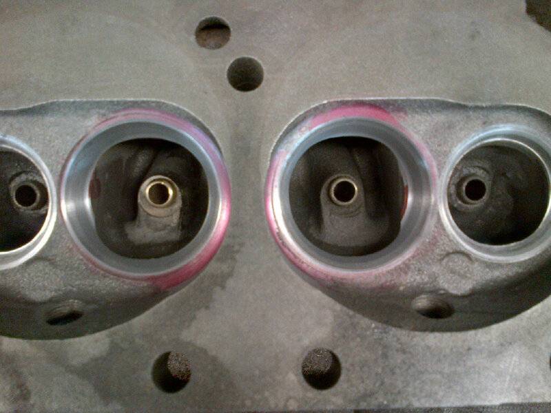

I agree. I’d love to find a set of 300k heads with 1.75 exhausts the same year. It’s pretty wild it’s been waiting 57 years for someone to finally wake it up. I can’t wait for the dyno print out to check out the lift. I’m going to have my imperial V8 completely refurbished as well. Maybe I’ll throw that back in, and throw this in a dart, or something. I have a spare torque flite from my ‘64 New Yorker too.
View attachment 1208461 View attachment 1208462
The 516’s will be fine for the passenger car that I’m putting it in. I’ll just need to adjust the rockers every 10k or so.
