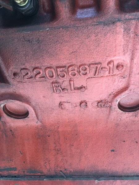

Hello. I’m brand new to this site. I have an engine question. 25 years ago I purchased a brand new still in the crate 413. Block 2205697 head is 2406516-2. The engine has mechanical tappets. Bore size is 4.19. A very reputable performance engine shop has verified that this is indeed brand new never started. They are in the process of doing a complete tear down, cleaning, installing hardened valve seats, etc. I’m going to have it put on a dyno as well. The engine is red from the factory with no stamp on the block yet. Any ideas on what year, and application for car that this may have been used for?

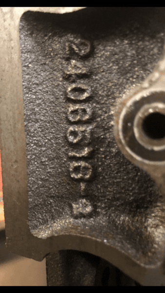

Here is a pic of the head casting. Looks like a poor cast job. Looks like a dash 2 better in person

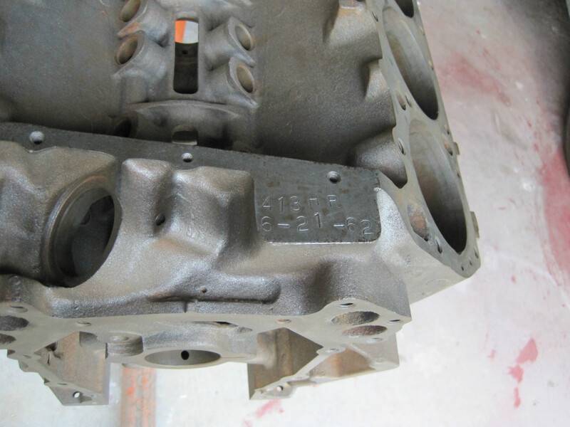

Is there anything stamped into the pad in the front of the engine right behind the water pump housing? There is a flat spot behind it. This picture shows where that information is stamped. I'm pretty sure even though it was a crate engine there should be some kind of build info on that pad.
That casting number was used from 1959 thru 1965 (413 and 426). Is there a stamp pad on the top front of the engine with any numbers or letters on it?

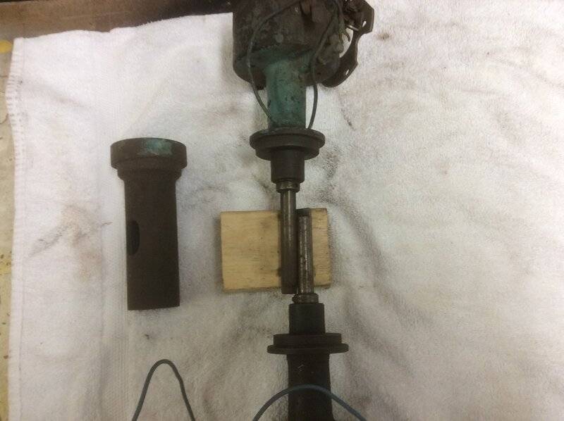

If it is a boat engine could be reverse rotation engine. If it has a distributor with this piece under distributor to keep distributor drive from pushing up on distributor shaft. The piece on left.
No stamp at all.
No stamp at all.
That's rather odd. But I guess not impossible. Usually it will contain a build date and or info about bearings if they are undersized or oversized etc etc...
Your block was casted on 1-6-1964 But assembly date would be on the pad. That block could have been assembled anytime.
If it is a boat engine could be reverse rotation engine. If it has a distributor with this piece under distributor to keep distributor drive from pushing up on distributor shaft. The piece on left.View attachment 1203156

Info I found says 2205697 block is 59-65 413, and 64 426 (street wedge obviously, not hemi or maxwedge).
Head casting 2406516, my info shows 64-67 361/383.
