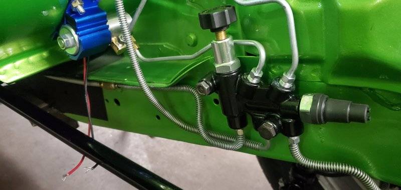

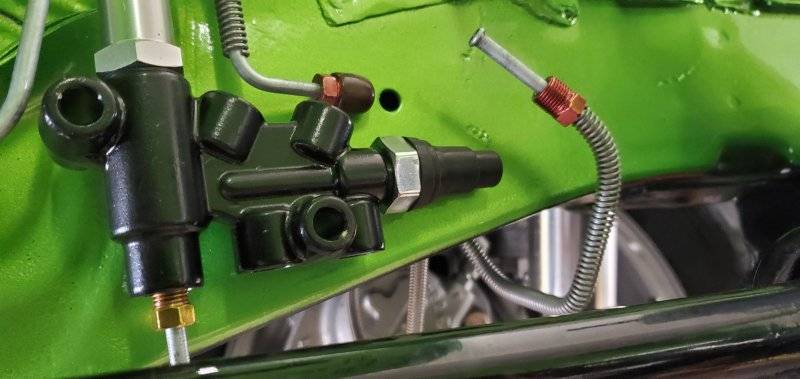

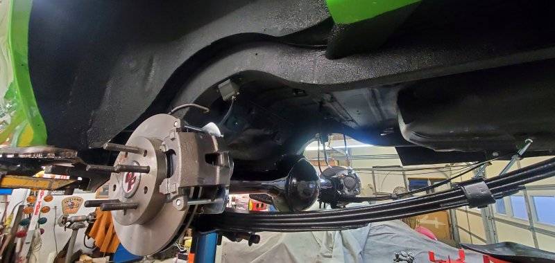

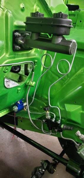

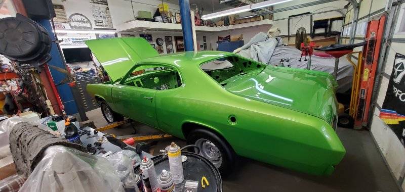

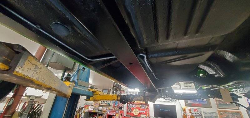

Our family friend Jeff grew up hanging around here as he and my son went to school together. He's wanted a hot rod for a long time. I found this Duster a few years ago from a guy at work. It had been setting 25 years . It's 340 car with lots of extra parts for $6k. Sold off the stock rebuilt short block, 340 exh manifolds, small A body 4 piston disc, and axle assy. It was a basket case but 99% rust free.4 doors, 4 fenders, 2 hoods, 2 deck lids, new ralle cluster, console, buckets. Recouped about 50% of the purchase price. I installed subframe connectors and narrowed a C body housing earlier. Well now it's finally painted. I agreed to help assemble it. It will be getting the turbo 360 out of my sons 62 Savoy. Been working on it about a week. Suspension and brakes are on. I repurposed the OE line kit to fit 4 wheel disc. Found a Summit proportioning valve and line lock. Rear brake are GM. Front are FMJ body. A little cut and flare with some creative rebending, and it's ready to bleed.

Very nice and at that price! Good luck with the project and keep the pic's coming! By the by,
Mopar never made a Turbo 360. If it's an older 727, you'll want to upgrade to a newer one.
Looks sweet. I had a 70 340. I loved that car. Bone stock with some carb and dist work it clicked off 14.0s at 99 to 100 like clock work.
Another awesome job,, by a master!
I like the color...
I like that body style (Duster/Demon) for an A-body
should haul ***, with that combo
(your son's car old combo, I assume)
A great looking A body in the making. Nice workmanship Doug and a great way to spend time in the off season.
