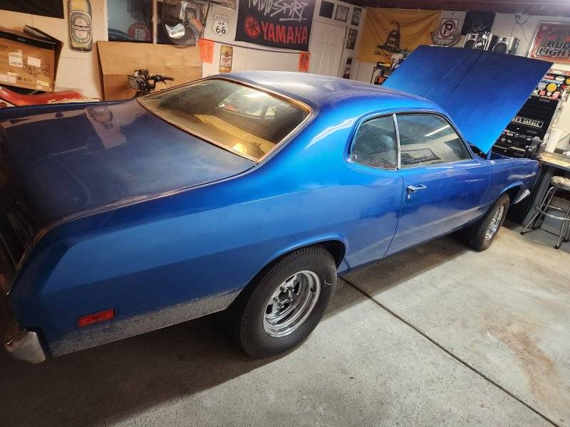

Not a B body. But something to keep me busy

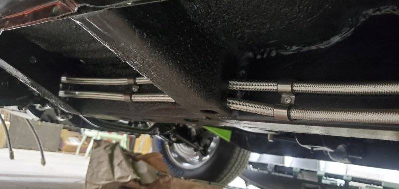

I used a chisel last time I cut braided lines and it’s the best way I’ve used so far.

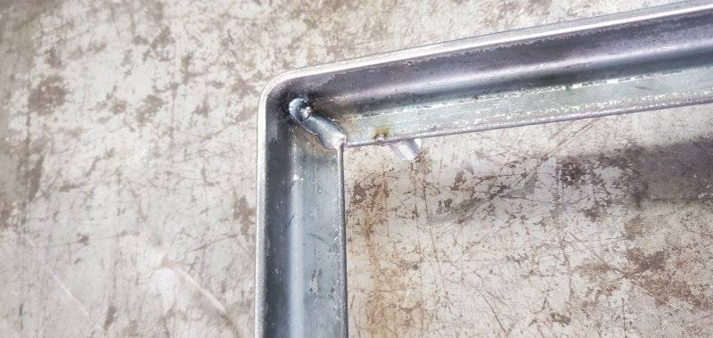

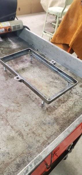

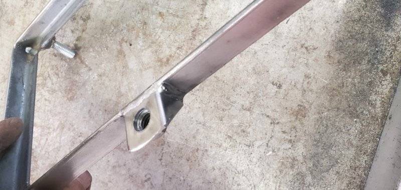

Car originally had PS. Converting to manul meant extending the shaft and procuring a manual coupler.i cut the weld and removed the solid portion of the shaft. Drilled the tube to 3/4" Tto remove the internal splines. Drilled a hole in the3/4"solid material for the steering coupler pin. Then plug welded and final welded the new 4" longer rod into the shaft. Whipped up a battery tray out of 3/4" angle. V cut the angle , bent it into a rectangle. Cut some square tube up at a 45 for the battery hold down studs. Well actually made two of them as I wanted one for my Road Runner as well.

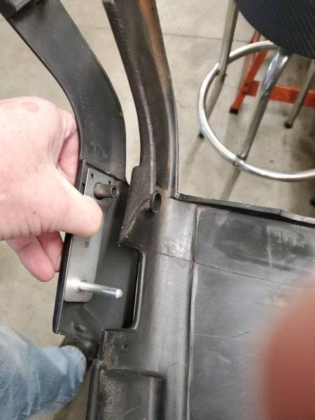

Now to the heater. I haven't had an A body apart in 30 years. So first we check the blower motor. Of course it's siezed. Got it all apart and cleaned. So that's set. The looking at the heater case there is no provision for defrost. Jeff tells me it was an AC car and he welded up the evaporator holes. He got this non AC box from my sons old Duster. But part of it went with that car. No defrost housing, cables or dash control assy. So we look at the AC box. Completely different. We buy a contole head and cables off Ebay. My friend Gerry has a non AC box so we get that. But will it bolt in? No ah ah. The hole in the firewall is at least 2" to big. My solution. Cut two aluminum plates that slide over the heater motor studs. One on the inside of the firewall. One on the outside. They sandwich the fire wall in between. The two unused AC box holes in the firewall will be usd for the oil pressure line and engine harness.

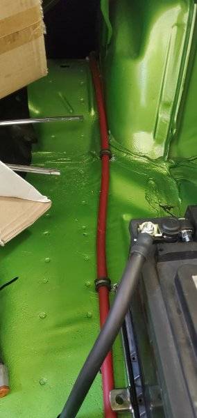

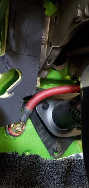

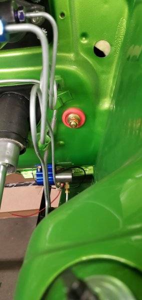

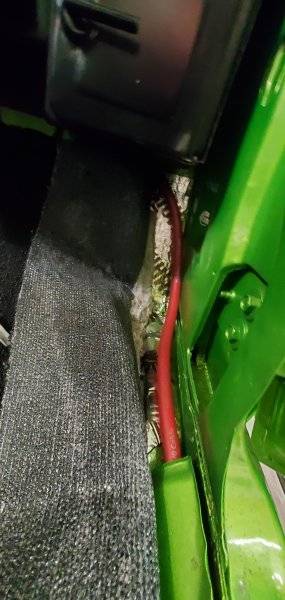

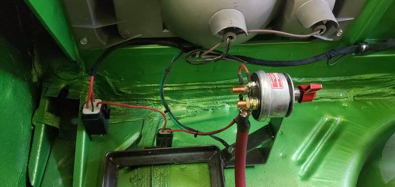

Finished up the trunk wiring yesterday. Routed the large cable back from a firewall bulkhead into the trunk. All the tailight harness got taped up along with the fuel pump wiring. Fuse and pump relay are mounted. Made a bracket and welded it to the tbattery tray for the switch. Jeff wants a rod coming through the reverse light to control the switch from the outside. Normal street use he'll just remove the knob and rod so it doesn't show.

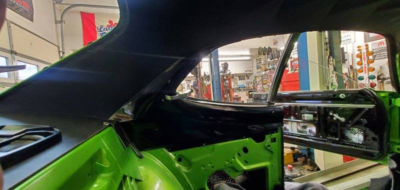

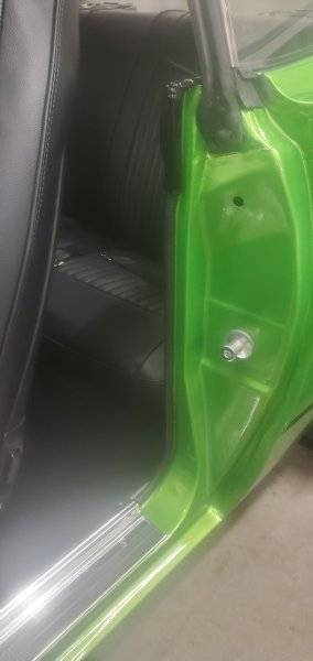

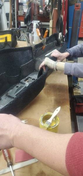

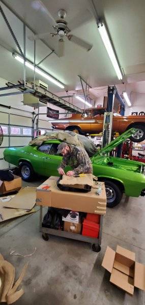

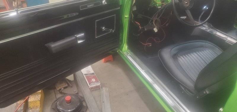

Got everything finished up in the interior except the dash. Most of the new parts fit pretty decent. My friends Phil and Virginia worked wonders on the seat cover install. While Jeff and I helped. Got the trim panels, arm rests, sill plate, kick panels, A pillars, knobs, and handles installed. Everything is brand new so it's really nice.
What is the reason for running the positive cable to the drivers side of the firewall? I'm getting ready to run a similar set up in my coronet, so I'm want to do it right the first time. Awesome pics! Thanks.
I ran mine there too. For the starter.
Easy to attach the starter cable to the pass thru.
