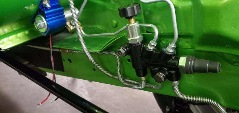

Our family friend Jeff grew up hanging around here as he and my son went to school together. He's wanted a hot rod for a long time. I found this Duster a few years ago from a guy at work. It had been setting 25 years . It's 340 car with lots of extra parts for $6k. Sold off the stock rebuilt short block, 340 exh manifolds, small A body 4 piston disc, and axle assy. It was a basket case but 99% rust free.4 doors, 4 fenders, 2 hoods, 2 deck lids, new ralle cluster, console, buckets. Recouped about 50% of the purchase price. I installed subframe connectors and narrowed a C body housing earlier. Well now it's finally painted. I agreed to help assemble it. It will be getting the turbo 360 out of my sons 62 Savoy. Been working on it about a week. Suspension and brakes are on. I repurposed the OE line kit to fit 4 wheel disc. Found a Summit proportioning valve and line lock. Rear brake are GM. Front are FMJ body. A little cut and flare with some creative rebending, and it's ready to bleed.

I was curious about the line lock on the rear circuit. Looks like that anyway.
You are 100% correct. It's incorrect. I made a diagram of the ports and paid no attension to it. I will be replumbing.
