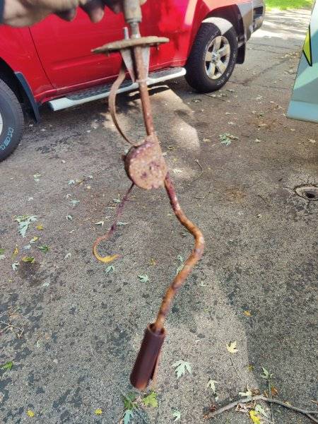

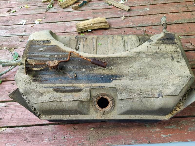

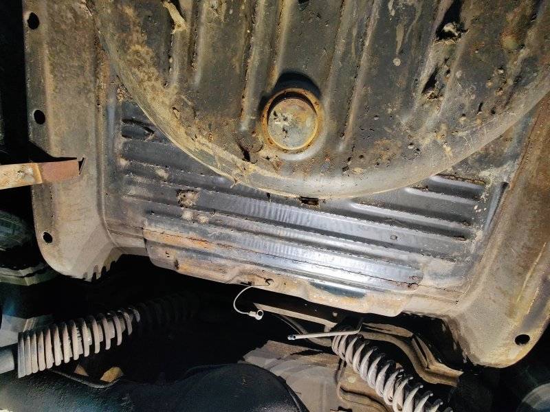

Sunday I took the time to drop the tank.
It had what I believe was an original tank. The float on the sender was disintegrated as was the strainer. Everything was pretty crusty.
I put in a new tank, stainless sender, new o-rings, and hoses for the filler neck and breather tubes.
I have yet to change out the pump (I had thought that was a point of failure the other day) but I do have one new in the box on the shelf.
There was still nice original paint on the floor above the tank.
Not the first time I've seen a "restored" car using the original fuel tank, with the internal crud eventually causing a problem. The first thing to ensure is a clean, airtight fuel delivery system. If it's not, everything else doesn't matter.
There is a good chance the insides of the original hard lines from the tank to the carb look at lot like that sending unit also.
