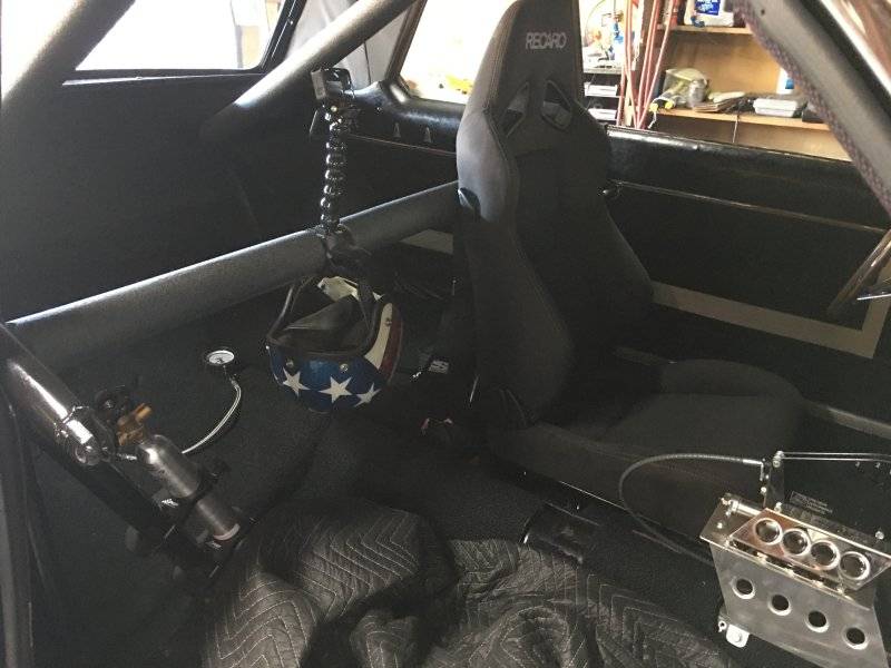

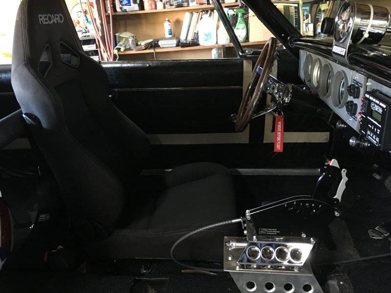

Electric shift addition for ‘24.
air shifter for 2024 ! and new much lighter recaro racing seats..
Those are some very serious upgrades. Have you been able to try them out yet?
still hooking everything up, configuring things then wiring and CO2 hose...those seats r lite and comfy on my old bones. tried to get a hold of the guy with the iron mega block today but nothing yet.....i did talk to another guy locally who bought 2 aluminum BM blocks 15 years ago, 1 a hemi and the other a wedge,,he's using the hemi and the other is in his house as a coffee table !,,wife died so there it is..which 1, iron or aluminum ?

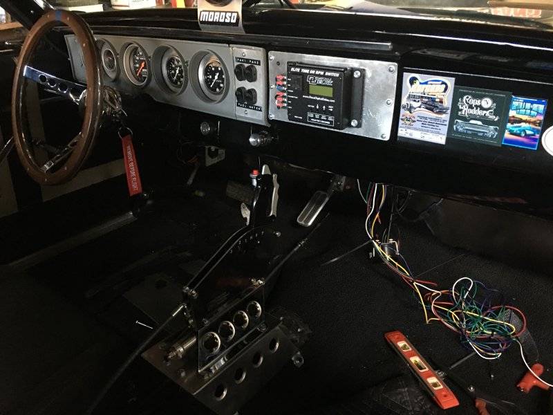

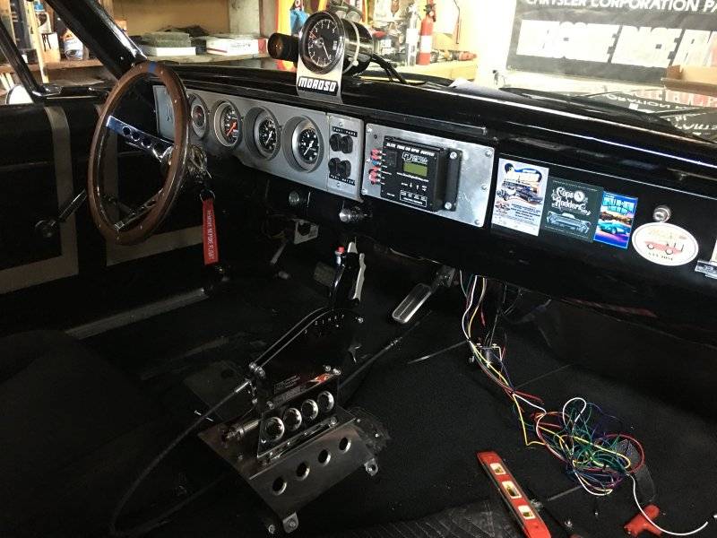

Hey Stage 3 - I’m not seeing a transbrake button? Foot braking must be.
No trans brake, size 13 foot only, when i was at Bakersfield nostalgia drags october i talked to this 75 year old man racing a 64 plymouth with the motor from hot rod garage, 511 max wedge making 728 HP. 1 of the pointers he gave me was get an air shifter, he said it will do 2 things,1 u will be more consistant and 2 u wont blow it up...his car was all steel running 10.50's with the kerky aluminum seat that looked Extremely Uncomfortable. even steel bumpers, i thought that adding just a FG hood he could get a more comfortable seat ! but thats just me. he also said that he stes the biondo RPM switch 400 RPM's before his shift point from 1-2 and 200 RPM before 2-3. and that with a 200 RPM shift point increase its good for a 1/10th...interesting stuff, So my air shifter assembly showed up a few days ago :thumbsup: and the recaro's days before that.

I personally see no reason for an air shifter. Mine repeats like clock work using the stock push buttons. I do agree on the earlier 1/2 shift. If you data log or use a play back tach you'll see that it takes a fair amount of time to fill the second gear servo. Thus increasing the time before the 1/2 shift is completed. The quicker the car, the earlier you need to shift. The shift itself always takes the same amount of time. A quicker car gains more rpm in that window of time. The 2/3 occors muchquicker.
Doug
Doug
It seems that the thing that moves the shifter handle in my car at the same time each time is the problem. :) Hoping this fixes that.

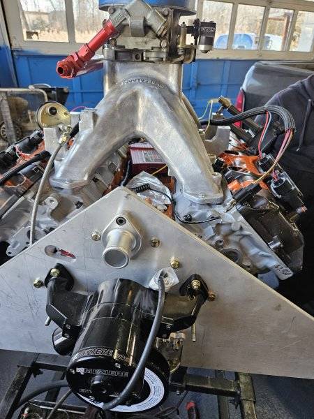

After trying everything to keep a 740 hp 440 together I've decided to abandon ship and try some newer stuff.

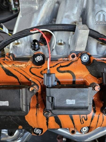

The engine is on the run stand. Working on this new stuff is a bit different for me. Sorting through sensors to get spark.
I finally have it figured out and hope to have it running this week.
I still need to get it into the car and set it up in the chassis.
I just rewired the whole car.
I'll have it ready for the track in the spring.
