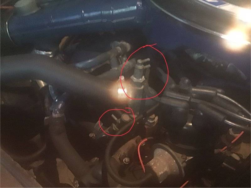

What are these for? 1973 Lincoln Mark IV 460. The one on the top is on the thermostat housing. The one on the bottom appears to be a heater hose. Neither are hooked up and they are not leaking coolant.
Emission control. Emission tag under the hood often gave them a name. If its your car get the factory service manual.
those are temp sensors,when they heat up they allow Vacuum to go from port to port.
you will need a factory manual or another untouched lincoln to see where they go to originally.

The upper one I believe is called a Ported Vacuum Switch.
The lower looks like some type of vacuum operated heater core bypass.
I've always understood that, when functioning as intended, that valve would allow the engine to reach normal temp quicker and also save wear on the heater core.

Nothing to do with heater core or water flow. Just a temperature controlled vacuum switch.

Thanks for the replies. I figured they were emissions junk. I briefly searched through the FSM but couldn’t find them so I thought you knowledgeable folks could help and you did. Much easier than digging through the FSM with a magnifying glass. My eyes aren’t what they used to be.
