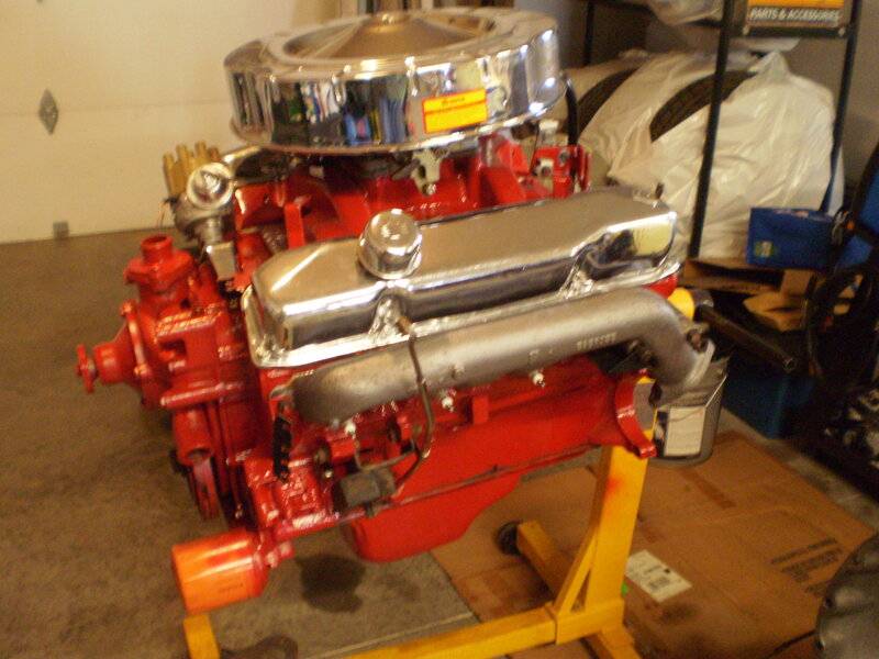

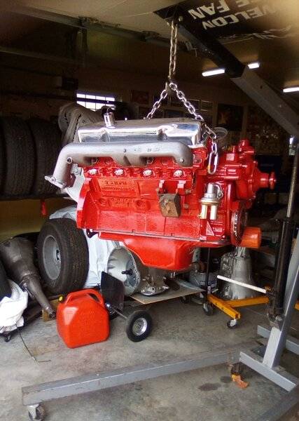

I sprayed VHT Clear over VHT Red on my Canadian big block almost a year ago. I still have not fired the motor up, so it should be cured by now.
IMG_20200927_141110_burst_01_kindlephoto-5426643[1].jpg P5020009.JPG P6130006.JPG
